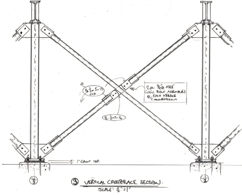

I am the drawing checker. I need to know what I can get away with rejecting. That drawing of your looks absolutely cool, and it shows off something that went away with drafting boards. The lettering is perhaps too cool to be completely readable.

When I check and seal shop drawings, my comments are similar to the 'red' marks above. I'm happy with that... With the handrail detail, there was another detail not shown that I added the shear and tension loads for the fastener.
You are part of a vanishing breed... fifty years back, plan checkers were common... and used to sign off on drawings... not so much today.
I almost never reject stuff... I correct it and have the EOR confirm my correction. This puts the onus back on him. If stuff is mis-spec'd (withdrawn spec, or whatever) I still have the EOR confirm the new spec. I often see stuff stipulating CSA S16.1 which was superceded 20 years ago... Current is S16. I don't put a date on it... my notes stipulate the current code stipulated edition.

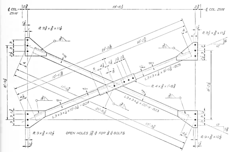

dik,
Interesting example, structural stuff.
What would you say about this one?
Nice...
That was the only reason, I didn't...
