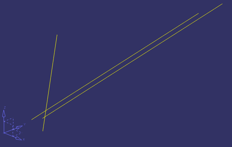

I tried executing the grx file. The splines are not joining all the points, they seem to be scattered. I ran the program for 3 dat files, please see the attached image of the output. Also, UG is responding very slowly. Is there any setting that I need to change?
 http://files.engineering.com/getfile.aspx?folder=9a2c0ac9-ea59-4589-8957-22fe62d010d0&file=Spline_not_continuous.JPG
Did you test it using the three data files you provided me?
When I ran it using NX 6.0 on my laptop and using the three data files provided, it took less than a second to create the three splines. This is what the results looked like when I did a 'Fit' after the program ran:

Thanks to you both. Both methods work!! Thanks a lot :)
I restarted my system & grx program worked fine.
