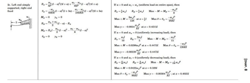

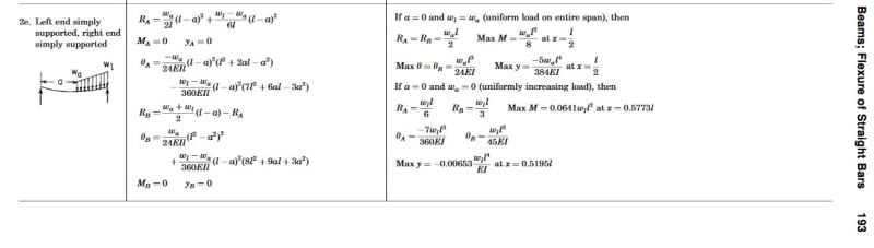

At least I understand the 425 x 9.25 / 32 = 122.8 plf.....
Hang on, I think Internet Archive just dropped Roark's from the free to look at feature.
