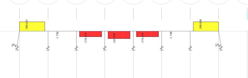

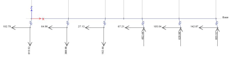

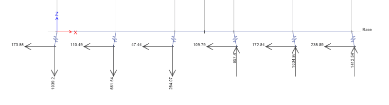

I can't help much in regards to the battered pile geotech theory, but I will throw in some quick computer modelling I did.
Image one is the all piles battered option, I went into etabs and made a link that had a battering angle of 10 degrees and a U1 (axial direction) stiffness of 1000 kip/in:
Image two is the last piles being battered:

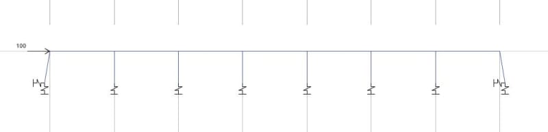

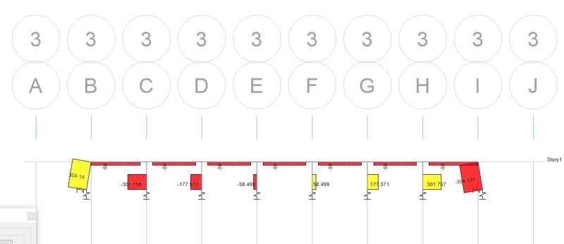

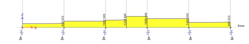

I did a similar trial model within Etabs - both with springs and fixed supports at the end of the piles. Similar to you - I also observed the "push pull" behavior in the "active pile" case.
Applied Loads:
Pile Axial Force:
Pile Cap Moment Diagram:
Pile Cap Shear Diagram:
This trial model only looks at the lateral load component on this exercise. Traditionally I expect that the push pull behavior in a condition such as this does not have as much impact on the "pull" piles as this force would be counteracting the pile demands due to overturning and axial. The shear diagram does identify additional pile cap shear which would need to be accounted for in a traditional design. I wonder if both of these conditions would hold true in a situation where a shear wall pile cap is experiencing bi-axial bending.

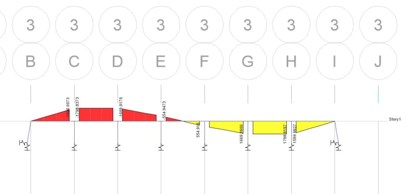

Can you post a moment and shear diagram from your trial model?
I don't think you are making a mountain out of a mole hill given the loads described. I think the fundamental problem is finding a linear solution to a non-linear (soil) problem. Deciding on the spring constants in S&T's model is difficult. I have compared our pile models using the soil spring analogy to the analysis by our geotech's that include the soil strata and was not thrilled at the differences. If you do not mind posting a snip of one of the soil logs I will mock up a model later to compare with others.
Shear - All Battered
Moment - All Battered
Axial - All Battered
Note that with a stiff wall above this element, I would be there would be a lot less shear and moment in the pile cap itself.
