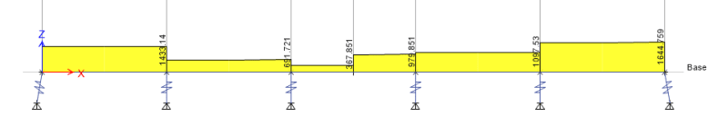

I am working on a building which must utilize batter piles to resist lateral loading as the upper soil strata are too weak to provide meaningful lateral resistance. I have found limited information regarding battered piles, especially worked out examples from a structural engineering perspective. Accordingly, the below and attached are my attempts at resolving lateral loads into a battered pile foundation system.
I believe there are two "methods" in which batter piles resist lateral loads, either through passive or active resistance (self described nomenclature here). Through passive resistance the batter piles resist lateral loads based on the horizontal component of the axial load in the batter pile. Through active resistance, the lateral load increases the axial load in the batter pile.
The attached worked out example attempts to work through the reactions on each of these methods.

Pile loads based on axial and moment demands are provided based on rigid pile group analysis

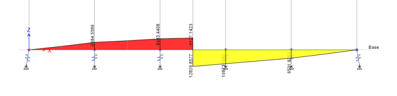

Generally, I am looking for feedback on my understanding of how to resolve lateral loads in a battered pile foundation. Specifically in the "active resistance case" as I appear unable to close the loop on the pile reactions. If anyone believes I am missing something in my worked out examples, please do share and I will aim incorporate the comments into this understanding.
 https://files.engineering.com/getfile.aspx?folder=4434bb99-fa04-4e7c-a214-634d25d16b13&file=Batter_Pile_Example_-_engtips.pdf
There is a large spike in shear in the "active" case as you described EZ building. Would keeping the battered pile under the shearwall chords help eliminate this large shear concern?
Shear - End Piles Battered
Moment - End Piles Battered

This resource agrees with and shows the "Active Batter Pile" push-pull that myself and S&T observed in our models
It also provides a FBD that closed the loop across the active forces - but does so across the entire pile group versus my attempt to do it locally across the push pull piles. This reinforces the concern that to utilize batter piles - your pile cap needs to be capable of engaging them.
The resource does not go into discussion about the shear spike in the pile cap or for how to approach the topic across more complex condition with bi-axial bending, torsion, etc.
