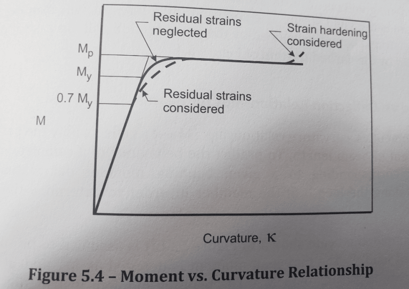

RE: Deformation
I think it's helpful to remember that even under so-called elastic loading (My), a beam would still be undergoing quazi-permanent deformation. In fact, deformation happens after only 70% of My. The thing is that
(A) it's really not a lot of deformation; and
(B) as dik notes, the actual service loads never really getting to the design loads (My or Mp depending on the case) given material reduction factors and loading factors
This allows us to assume an elastic response to an My loading +/- unless there are large compressive residual stresses in the flange tips. And we do.
Now, for class 1/2 sections reaching Mp it's a bit harder to say that the deformation required to achieve Mp is negligible (as we did for My). But going back to what dik mentioned, I think the small shape factor (Mp / My) combined with large loading factors keeps service loads much closer to My and hence things, generally speaking, don't become overly deformed even if designed to be (see above for My deformations being negligible).
Typical Shape Factor = 1.12 (W310x52) to 1.18 (W610x551)
Typical Loading Factors = 1.25 (Dead Loading) to 1.5 (Live or variable Loading)
Now, it isn't quite a 1:1 comparison because the loading factors take into account the statistical nature of load and the idealized nature of it in design (e.g. uniform when not really). But it does go to dik's point that since the lowest typical loading factors is ~ 67% larger than the average Shape Factor (1.25 / 1.15) it seems reasonable to say that, on average, even if we design with Mp we are unlikely to get there in service.

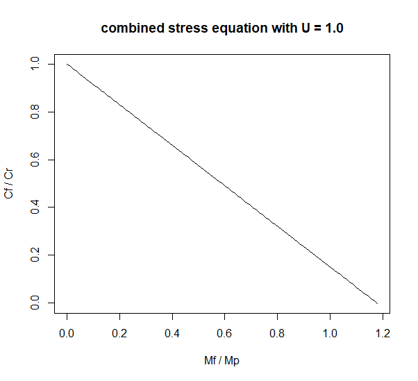

KootK: So we agree that the combined stress equation doesn't take it into account explicitly (obviously). But you posit that it might be implicitly taken into account by limiting the Mf / Mr term via an interaction with U in the presence of some axial load. Meaning, it's a nothing burger because it's never seen. I disagree with that as a simple example shows:
Take my above example of a W310x74 with K=1, Lu = 1250mm -> Cr = 2820kN << Ce = 206,972kN -> ~ U1x = 1.0
The U-factor is doing nothing here because even with Cf ~= Cr -> U1x ~ 1.0.
Lets say that we have Cf = 0.10*Cr. What happens to the flexure component? Well it's a C1 section so Mr = Mp. We get,
0.10 * (Cr /Cr) + 0.85 * 1.0 * Mp / Mp <= 1.0 ----> 0.95 <= 1.0 TRUE
This is a realistic design example where the plastic moment is allowed to occur by the combined stress equation even without transient states being considered. Moreover, in the presence of high axial load the U factor wouldn't limit Mf it would simply be the Cf/Cr term that does the job.
All I am saying is that this equation, neither explicitly nor implicitly via the U-factor or otherwise, necessarily limits the design moment to being less than Mp. That is to say nothing of transient states which are not explicitly prohibited. Note: I am not saying I advocate designing this way just that I think it's quite grey as to if the code allows for it or not.

And do you do moment magnification for P-smalldelta in your analysis, or is the U factor the only time within-span deflections are accounted for in this respect?
Designer's choice I believe. That said, in my experience, most beam columns will be designed with the U-factor method of accounting for P-baby-delta.
Is 1.18 = 1/0.85 = a factor that accounts for strain hardening in the Australian code for stocky, symmetric shapes?
