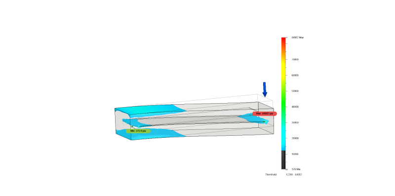

The below fusion 360 FEA (Quickly done) shows about 12-10 KSI (Von Misses) just next to the weld. But that could be a hot spot, this model would need more work to fully converge the solution. There is a .03" gap between the plates and 1/2" of metal connecting on each end to simulate the welds. I did use a full radius to minimize a singularity/hot spot at the slot edge. i expected to see more stress at the welds, this shows the higher stress just before the weld.
In any case, when in doubt I will use a a few plug welds with a doubler plate to get several plates to act as one, when they are much wider then the 2" I assumed. Which appears to be the actual case. i do not think the OP Ted needs a plug welds. Unless loads/stresses are real high
