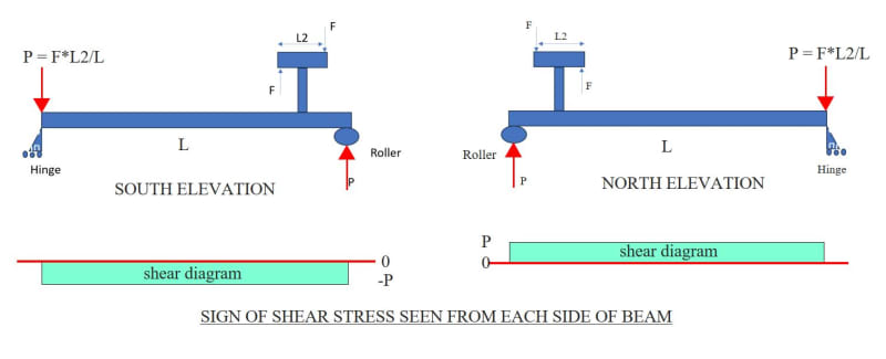

Bending moment, Shear force for a beam on a simply supported beam. 4
pike12
May 18, 2023
7
From the problem in the image, how do we express P in terms of F? Does the couple generated by the I-beam on top of simply supported beam translate as-is into the bottom section and we can draw this as just another beam with 3 point loads? I am trying to refresh my Strength of Materials knowledge but don't know how to approach this.
Thank you, in advance.
 https://files.engineering.com/getfile.aspx?folder=8bc2182e-d03d-4957-ae45-e9e81e5f187f&file=SFD_BEAM1.PNG

Shear stress as seen from each side of the beam (Y axis pointing upward). If the Y axis points downward, the sign of the shear stress is reversed.
I checked this with software. I divided the "a" portion of the beam into 3 equal segments, just to illustrate the increasing moment from Joint 1 to Joint 4 (where the frame is attached).
P = 5k
a = 16 ft
b = 4 ft
L = 6 ft (I changed symbol for L2 to simply "L")
HT = 10 ft (even though HT does not matter to the beam solution)
R1 = -1.5k
P = R2 = 1.5k
V = -1.5k throughout beam
M1 = 0.
M4L = -288. k-in [left side of Joint 4]
M4R = 72. k-in (right side of Joing 4)
M5 = 0.
It's a little difficult to do by hand because we are so practiced to draw shear and moment diagrams for the typical beam loads of concentrated forces and uniform loads. Adding the moment from the frame just makes our brains work a little harder.
To solve for P
Sum(M) = 0 = F(L/2)*2 - P(a+b)
P(a+b) = F*L2
P = F*L/(a+b) =5k*6'/(16'+4') = 30/20 = 1.5 k

P = 5k; should be F = 5k, right?
a = 16 ft
b = 4 ft
L = 6 ft (I changed symbol for L2 to simply "L".) L was already used for total span (a+b), but okay.
HT = 10 ft (even though HT does not matter to the beam solution) HT is height of Tee.
