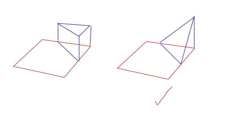

I think it is the centroid of the volume bounded by the triangle area (fc varies linearly from maximum on the top, to zero at NA).
as Retired indicated you have a linear increasing stress on a linear reducing cross section the result compressive force ends up a the height of the stress block, x1, / 2 in this case.
If your interested I posted the general formulas for a linear varying stress and a piecewise linear section boundary in this thread, second to last post:
You can verify the centroid location of this solid volume using auto-cad, or maybe 3D shape builder program.

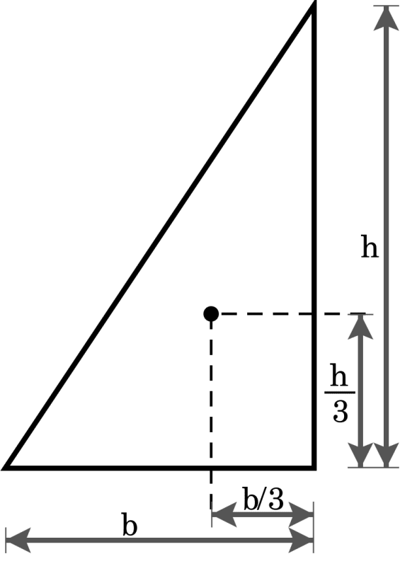

If I am not mistaken, the centroid of a triangular shape is:
This is why I don't understand that Fc is located at x1/2 from NA..I'm a little bit confused [3eyes]
for a triangular shape that would be the centroid, but in this case you are really looking at a 3D prism. If the stress was constant over the area then you could use the standard 2D triangle centroid but your stress is linear so you need to do the double integral of the stress function to get the volume which is equal to the force, Fc, and another double integral with x or y*stress function which yields the first moments of area which are equal to the My, Mx moments caused by Fc.

For any triangular shape with zero stress at the base and maximum stress at the crown, and linear distribution:
With x measured from the base, depth D and base width B:
For simplicity take max stress = D:
Stress = x
Width = B(1-x/D)
Force = Integral(0 to D): Bx(1-x/D) = B(D^2/2 - D^3/3D) = BD^2/6
Moment = Integral(0 to D): Bx^2(1-x/D) = B(D^3/3 - D^4/4D) = BD^3/12
Height of centre of force = (BD^3/12)/(BD^2/6) = D/2
