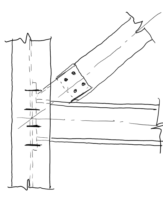

As the subjects suggests , this joint has been giving me headaches.
In the direction of the column main axis, I have a moment connected main beam and I need the back transverse stiffeners in the column.
How do I connect the strut and brace in the other direction while maintaining erect-ability of course .
I've seen the following 2 samples connections before, so can anyone give me advantages and disadvantages of each ?
what checks may be critical that might pass me by ?
or if there are any other suggested shapes.

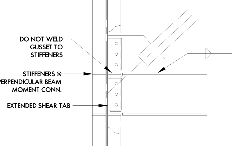

These are tricky connections. My experience has always been with a connection similar to the second one you posted. The single "extended shear tab" that connects to the web and brace is better than the rectangular "shear tab" and additional gusset for the brace. The first option has some additional eccentricity, fabrication, and load path issues that are better handled by the (preferred) second option. I've seen the second option but with a straight down cut instead of the profile cut. That was the preference of our shop since the nesting of the profiled plates created just as much waste.
Here are some things to think about:
A. Confirm the load case (ie. which member is in tension/compression) you are checking. This will affect the resultant force.
B. Check whether the force distribution based on the bolts handling the rotation or the rotation at the stiffeners.
C. What's the brace doing at the other end? You can save the field team some problems if you keep an eye on that.
D. Generally the checks are the same as for a shear tab: member end connection, bolt resistance, plate strength, plate stability, stiffener strength, weld strength, column strength and stability.
E. The main issue with these connections was always geometry driven. The eccentricities are small (width of a web, perhaps) but can add up.
Good luck.
1) I don't like the first one. Way too much eccentricity and plate bending.
2) The second one might be simplified by eliminating the second stiffener from the bottom. I don't think that you need that stiffener because your incoming strong axis beam will be delivering its moments through the haunch flange.
3) Given the option, I'd shift the brace work point such that the entire brace connection is to the beam and only the beam. This impacts the beam design, of course, but that's usually minor in my experience relative to the benefit to the connection. If you're a fabricator and not the EOR, you likely won't have this option.

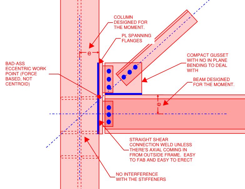

Here's my stab at the connection. This seems pretty easy to fabricate:
bhiggins, depending on what the connection looks like on the opposite end of the beam, that might be very difficult to erect - the horizontal stiffeners and the shear tab create a pocket that the end of the beam has to fit in to, which means the beam has to be brought in fairly straight on.
I like Agent666's detail, and use that style of connection often. But with the horizontal stiffeners in the column, I don't think it will work. Option 2 is definitely the better option in the OP. It's going to be ugly no matter what.
Human909, main reason I like it if it works (as others have noted may not in this situation) is that the eccentricity is virtually zero, so for a little hassle in the erection you all but do away with all the secondary eccentricity moments present in the other details. The end plate doesn't usually need to be thick because its only delivering a vertical shear to the web. Theres no (or its very small) horizontal loads going into the web. So in the right situations this can help quite a bit in keeping your column sizes down a weight or size due to no moment like you get in many of the other connections where you might be resolving force distribution created by implementing uniform force method or similar means.

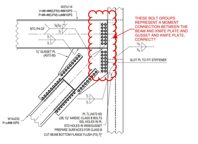

I design this type of connection from time to time. An extended shear tab give your erector flexibility and is "easily" fabricated. Based on the number of bolts you're using, your steel members look very light. If the column web has trouble taking the UFM force, add a doubler plate. The good thing about steel is it's reliable and you can stiffen the column to accommodate many types of connections.
 https://files.engineering.com/getfile.aspx?folder=5019adb5-a2bf-4564-b331-0c5ae3e15e3d&file=combined_pl_brace.pdf
Is IDEA STATICA reliable when analyzing all of these connections ? because manual calculations will take really long time
I have no idea about that computer program, but the calculation's are relatively simple. I use the modified uniform force method provided in AISC Engineering Journal, 1st quarter, 2008 (free for members), but the standard UFM also works fine.
Add the UFM forces to the beam's reaction forces, then design the extended plate for total shear and axial. The extended shear plate will be designed for the combined shear values of the beam + gusset and maximum axial from either (minimal due to beam-to-column-web conx.). That's my strategy. Best of luck to you.

Doesn't this look easy to fabricate and erect? I obviously don't know the scale of the member size impact here so that's something that would need to be evaluated on a case by case basis.
Another, subtler argument that I'd make against a strict adherence to eccentricity elimination is that, based on the varying stiffenesses of the connection elements, I tend to be pretty skeptical that eccentricities are really eliminated to the extent that we tell ourselves they are. Especially when bolt are involved with their inherent slip. I almost consider 1/2 member depth to be a reasonable, minimum eccentricity for the member design regardless of the connection detailing.
Meh. I'm not a huge fan for that connection above. Why?
1. You're blocking in a portion of the column. So your erection sequence has to be dialed in if there are bolted connections coming in to the flanges. How else would you place those bolts?
2. You're blocking in a portion of the column. So now you'll have to provide some sort of drainage hole in your stiffeners. Sure. It's just a drilled hole, but if you have 200 of these on a project, then you need to have 200 stiffeners carried over to the drill line (adding another timing step and potential for QC/QA) or you're now subdividing that piece mark into "avec drilled hole" or "sans drilled hole" [EDIT: Also fire rating for that blocked portion]
3. You're blocking in a portion of the column. So your plate spanning across the flanges will get (potentially) a one-sided weld on the outside. This would be best if it's a shop weld, but because of the placement, it might be a costly field weld.
I don't like blocking in a portion of the column because you lose access. If things in the field deviate, I'm not sure which connection I would like to "fix" but it probably wouldn't be the one with blocked access. It's a great design concept for force transfer, though. And if your PM and shop QC can really identify the scale vs. cost for this (versus less "multiple piece connection") I think you could challenge convention and go for it.
I do like the straight cut gusset for the brace, though. And I do like your thoughts #1 through #5. Spot on. Mandatory fabricator experience for everyone.
KootK,
I like it. However, provided the brace goes into tension, the weld connection your cover plate to the flanges will see some axial.
It's still pretty straightforward, with just a little bit of force accounting to do. But certainly much easier than a full-blown UFM.
