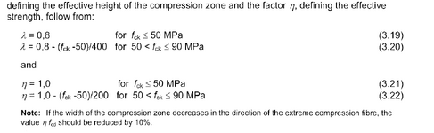

Further you mentioned, that when calculating concrete stress, "where the section in compression is triangular the rectangular stress block is unconservative. Eurocode 2 has a reduction factor to allow for this, or use a parabolic-rectangular stress block for a more accurate result (although that makes the concrete force and moment calculations more complicated)."
So, I went through the Eurocode and found the following clause. I believe you're referring to this? If so, it says 0.8 as reduction factor, that's essentially the same reduction factor I used for rectangular compression area. As I used 0.8x (where x being the NA to compression fibre distance). So, if I follow the Eurocode factor, then there's nothing more I need to do as it's already reduced to 0.8x?
For the stress, I initially thought, since it's a triangular area, we need to divide fcd by 2 (Fcd/2), but then I noticed, the eurocode says "if the width of the compression zone decreases in the direction of the extreme compression fibre, the value "η fcd" should be reduced by 10%. I guess this is referring to triangular compression area we're having? so upto 50 MPa "η fcd" value that should be 0.9 * 1 * fcd, further reducing the stress towards the safety. So, that means if we use "0.9", we don't have to divide the fcd by 2?
@IDS
Thank you.
The lambda factor (0.8) is to account for the effect of replacing a varying, parabolic-linear, stress distribution with a uniform stress. It is based on a rectangular section but it is applicable to any shape.
I was talking about the additional 10% reduction in your 3rd paragraph. This additional reduction is because the average stress due to a parabolic-linear distribution applied to a triangle (with zero stress at the base) is reduced, because the wider part of the shape has the varying stress, and the area with uniform stress is reduced.
The design uniform stress (0.9*1.0*cd in this case) should be applied to the area of the triangular compression zone (allowing for the lambda factor). Why would you divide it by 2?
