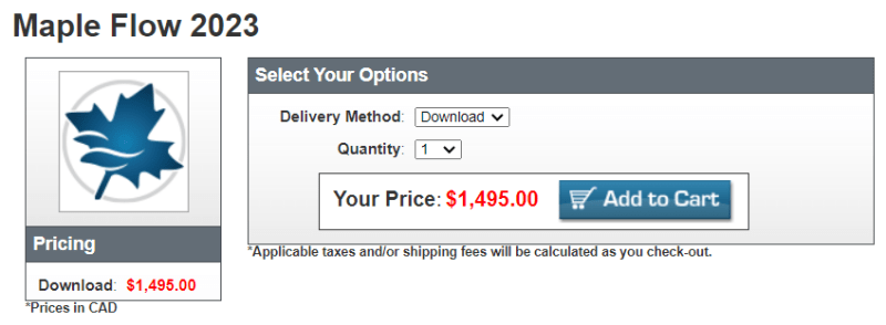

In my quest to find a replacement for Smath, I came across this. Not free but looks promising and not that expensive. Anyone messed with it?
Blockpad
@phamENG: I was going to disagree with you, but did some investigating. It appears that the price is "currency agnostic" $1495 CAD if you are buying from Canada or $1495 USD if you are buying from the States (taxes etc. calculated and checkout). This is arguably pretty hilarious...
I wonder what their program would do if you put in pound-mass vs pound-force. It might be agnostic on that too. LOL
