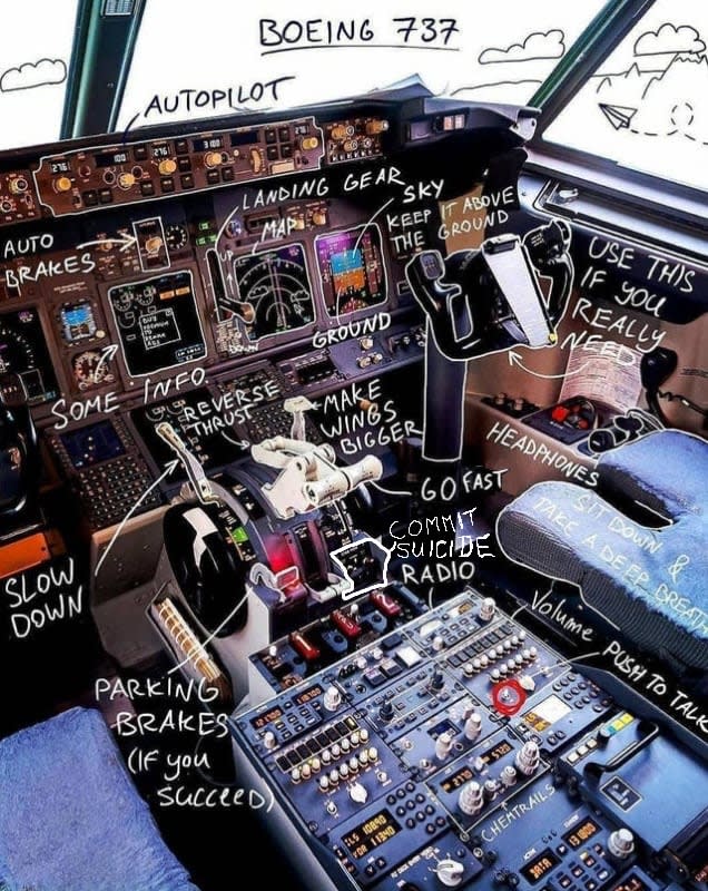

Just got this...
The 737 sim is commonly used for checks when you go for jobs even if its for a turboprop. Its also used for doing a course in Euroland called the Multicrew cooperation course which is about working together as a team and communicating not flying the aircraft type your using the sim of. We do it before the first multicrew type. This is mainly due to the huge numbers of 737 sims and also the availability. So most of us at some point have flown the 737 sim in a very reduced form. As you can see from that pic there is buttons and switches everywhere. But that doesn't give the full picture.

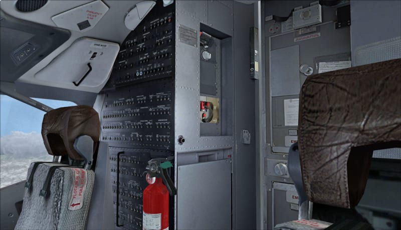

And then the infamous CB panel. This is the main one behind the LHS but there is another smaller one behind the RHS.
There is quite a few QRH procedures that require you to find a CB on those panels using a grid allocation and pull it. Which is what the stick shaker cancellation discussion is all about. One pilot has to get out of there seat to find it and pull it. And as you can see by the cockpit picture there is no space left to put a button.
@dik, artist didn't manage to label the powered trim cutout, did they.
@moon...[bigsmile]
moon there isn't on one in the max apparently there is only a electrical trim motor isolate which covers both flight control mandatory inputs and electrical manual trim control. Unlike the NG.
Once its off your on your own...... if you are inside the +- 10 knot window you can actually physically trim in....if your not you need to turn it on again against the QRH to actually survive.
