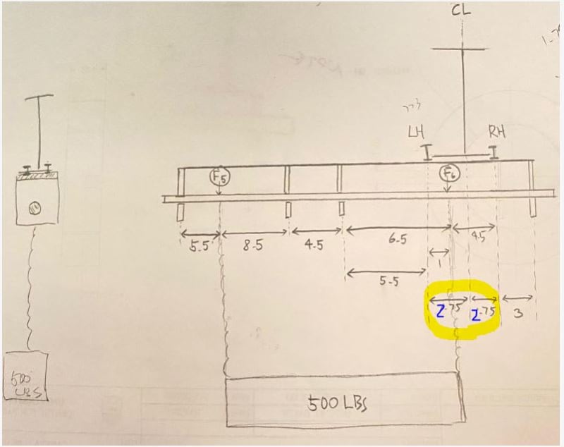

Hello
Would anyone please help me with this calculation?
My goal is to know the proper preload for the 4 bolts that hold the I-beam and the beam structure together, using the clamps.
I used 5/8" grade 5 bolts.
and How to calculate the axial bolt force of the bolts? I ran FEA simulation and I would like to compare the simulation was run properly. so I thought I could compare the hand calculation of axial force to simulation result.
Please let me know if there need to be more information.
Thank you

"1.75" should be "2.75" ... no?
yeah, I summed moments about two different points ... should've gotten the same result (obviously).
I think in my solutions the moments are calculated correctly ...
1) 250*23 is the moment at the CL of the joint,
2) 250*28.5 is the moment at the RH reaction (the RH clamp, 3" from the RH end) ... that looks right ! (the difference should be 250*2*2.75, no?)
I think I messed up with the bolt loads ...
1) LH load is 500/4 + (250*23/5.5)/2 = 125+523 = 648 lbs
2) LH load is (250*28.5/5.5)/2 = 648 lbs
the difference is in 1) I've moved the load (reaction) to the middle of the clamps, so I need to add the direct shear; in 2) I've summed the moment about one reaction, so the LH reaction * 5.5 equals this moment ... yes? (and I shouldn't've added the direct shear load)
this result is in line with desertfox's calc, once you 1/2 the load (500 lbs, not 1000lbs, for a reaction of 690 lbs).
the RH reaction is the applied load (500 lbs) less the LH reaction (2*648), so (500-1296)/2 = -398 lbs

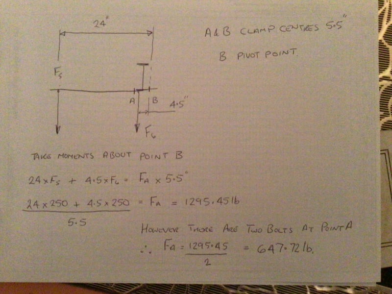

Hi
I have recalculated on the basis of the new information and posted my working out for the bolt load due to the external load offset below.
Need to add the direct load each bolt experiences which is 500lb/4 giving a max bolt load of 772.72lb.

Hello rb1957
I can understand your 2nd approach very well. I appreciate it.
but, I still don't understand 5.5" to calculate load on LH. I still think it should be 2.75" which is the distance between LH and CL.
Is this your 1st approach?
1)Calculate Moment around CL.
2)When calculating load on RH, use distance 5.5" based on pivot point (LH)
3)Add direct shear load, (since the calculated moment location and pivot point to calculate a load on RH is different)
and, I messed up my drawing, it should have been 2.75" as below.
Thank you
Hi YOUNGTAKI
You can’t solve the loads if you take moments about the CL there are to many unknowns.
well, IMHO, you can ... but it is less intuitive.
the moment about the center of the fasteners is reacted by a couple 5.5" apart, and there are two fasteners, so the load is M/11
Hello @ desertfox @ rb1957
I am curious about the direct shear load.
I think the moment calculated from desertfox and rb1957 are identical.(rb1957's second approach)
but desertfox added direct shear load to the load calculated from moment.
and rb1957 didn't add the direct shear load.
my second solution I'm taking moments about the RH clamp, both applied loads and the reaction at the LH clamp ... so nothing to "add".
in my first solution I took (for whatever reason) the loads to the middle of the clamps (ie the loads, where they are, are equivalnet to a shear and a moment at the center of the clamps, yes?). so I have to combine the moment reaction and the shear reaction.
since I get the same result, it's a pretty fair bet that it's right !? as I've said already the 2nd solution is much more intuitive (for those of us who do it for a living).
Hi YOUNGTAKI
Best way I can explain this regarding adding a direct load and not what you are calling a shear load, right if you look at my post with the diagram on posted earlier. I took moments about the RH clamp edge and the loads in the bolts have to balance the moment created by the offset loads and in addition downward forces have to be cancelled out by upward forces to maintain equilibrium, so I have 500lb force acting downwards which is shared equally across the four bolts ie 500/4 = 125lbs and so I add the 125lbs to the bolt force required to cancel out the moments
