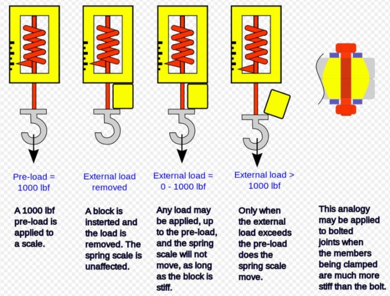

you 've got several responses saying the same (correct IMO) thing ... external load is not added to the preload. preload compresses the joint together and reacts the large proportion of the applied load. A simplistic bolt load diagram shows the load in the bolt is the preload until the applied load = preload when the joint gaps and all the load is now carried by the bolt. Thus the bolt is still good for it's rated load whatever the preload.

you guys realise you're both saying the same thing ?
when the joint is clamped together the external load is shared between the joint faces (compression) and the bolt
when the joint is gapped, all the eternal load is reacted by the bolt.

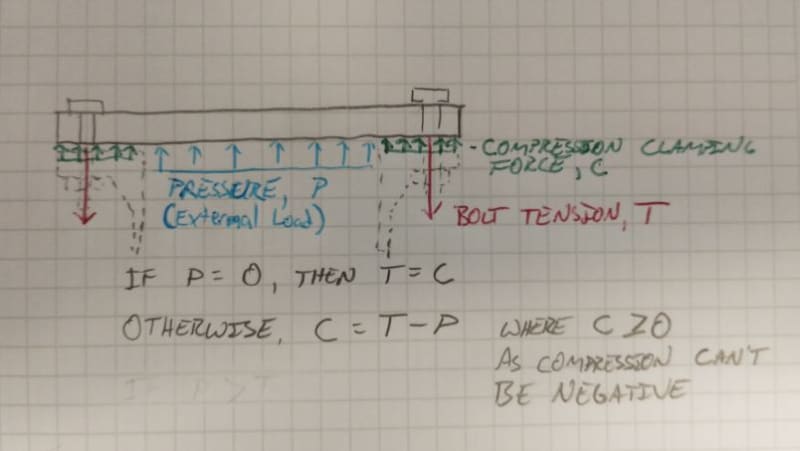

No rb1957, we are not saying the same thing. In fact, your first statement, "when the joint is clamped together the external load is shared between the joint faces (compression) and the bolt" is also incorrect.
The external load applied on the cap is only ever resisted by the bolt tension, there is no sharing this tension with the joint faces.
You could say that the tension in the bolt is resisted by both the external force and the clamping force. That is, as the external force is increased, the clamping force decreases so that the tension in the bolt remains constant.

The compression on the joint faces is due to an internal load (bolt pretension), it is not due to an external load (pressure in vessel).
Stating that the load is shared between the joint faces and the bolt is very misleading. The joint faces are not resisting the external load. The joint faces are resisting the internal load that is caused by the clamping force due to bolt pretension. As an external load is applied to the endcap, it is only resisted by the bolts (no sharing). However, as stated before, this results in the internal clamping force (caused by the bolts) to decrease.
rb1957 said:
external tension load will increase the bolt tension and reduce the joint compression;
No. The external tension load (again, this is the pressure on the end cap) will reduce the joint compression and the bolt tension will remain the same.
rb1957 said:
until the joint compression is zero (the joint is gapped) and all the external load is in the bolt.
Yes. Except that all of the external load was always in the bolt. The change is that there is no longer any load in the bolt due to the resistance of the clamped parts.

The tension in the bolt is 40kN
You start with a tension in the bolt that is 40kN, this is resisted by the compression between the two faces of the joint, also equal to 40kN.
You apply an external load of 30kN. The bolt still has a tension force of 40kN, however to maintain equilibrium, this means the compression force between the faces of the plates is now only 10kN.

Please go back and look at the initial picture that I posted (actually, I'll repost it). For the OP's example the red spring is the bolt, the yellow box holding the spring scale is the flange and the block that is in inserted would be the endcap. The external load applied to the hook would be the pressure applied to the endcap.
As can be seen in that image, the external force is only resisted by the bolt tension. The the block or endcap does not magically stick to the flange without the bolt (this is what load sharing would imply). The clamping force is a function of both the bolt preload and the external load. i.e. the clamping force changes when the external load changes, but this does not mean that the flange faces "share" the external load with the bolt.
