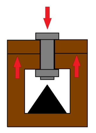

desertfox said:
In fact even your diagram is incorrect because the spring representing the bolt doesn't move until the external force exceeds the preload,
This is the disconnect I was talking about in my previous post.
This is not incorrect with the assumptions that were made (and noted in the diagram). The assumption is that the block is many times stiffer than the bolt or spring. That is, in the calculation you posted, the stiffness of the steel plates Kp is taken as infinity. If it is, your joint constant C becomes 0, the increase of force in the bolt is therefore 0, and the decrease in the clamp force is equal to the full external load. That does not mean that the bolt is not carrying the load of the external force. It means that as the bolt takes the load of the external force, it releases some of the clamping force that is causing load in the bolt, so that the clamping force is no longer causing a stress in the bolt. With an infinitely rigid plate this is a 1:1 relationship.
This is the point I have been trying to make regarding the load path.
To me, stating that the load is shared between the bolt and the clamped plates indicates a belief/understanding that tension is somehow transferred between the plates, when clearly it is not (maybe I'm the only one who interprets it that way?). The load path for any tension must be through the bolt, there is nothing else in the joint providing resistance to tension. The external load causes tension in the bolt, so does the plates resistance to compression (clamp force). The clamp force between the plates decreases when an external load is applied because the stress/force in the bolt that was previously causing clamping action is now resisting the external force and is no longer developing that clamp force. A decrease in compression between the plates (which is caused by the tension in bolt) due to an external force being applied is not the same thing as load sharing between the bolt and the plates (again, to me, and how I interpret that statement).
I also understand/recognize that in reality the clamped plates are not infinitely stiff. But starting at that point can help with understanding what is actually happening in the joint before complicating the issue more.

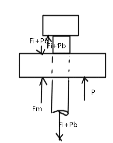

I actually pointed out the rigid assumption disconnect in my post that is time stamped,9 Jan 21 13:41. This was simply the following morning after my previous post. Here is what I said, "Ok, now I understand one disconnect. I was assuming the stiffness of the flanges was much greater than that of the bolt as alluded to in the second example in the OP. If that is true the increase in the tension of the bolt is negligible (which your equations show)." Sorry if this didn't clearly depict the rigid assumption, I thought that it did.
Next we also have your statement “the bolt is the only load path” again totally wrong.
No, this is not wrong. This is our sticking point. Please take a look at the FBD below (initially provided by, goutam_freelance) and show me where or how there is any load path for the external load other than through the bolt.
There is nothing in the OP’s post that states the flanges were rigid.
Here is the statement in the OP that I am referring to (highlight is from me):
"Or lets give you another really simple example just to illustrate the point I'm trying to make here:
Lets say you have an M6 eye bolt, you insert it through a hole [highlight #FCE94F]in a rigid steel plate[/highlight] in the ceiling, and screw a nut on the other side. If the nut is not tightened, then you can hang 11.29 kN load on your eye bolt before it breaks, but after you've tightened the nut according to VDI2230, you can only hang 11.29 kN x 8% = 0.9 kN off it before it snaps!."
So yes, the OP did include this assumption to help with the overall concept.

I did not disagree with this statement. I disagreed with your first statement. This statement does not support your first statement, here is why:
What is causing the compressive stresses generated at the flanges? The bolt is.
Why does the bolt stop generating these compressive stresses? Because the bolt is now resisting the external load.
That is, some of the stress in the bolt is now being caused by 100% of the external load and the rest is still being caused by the remaining clamping force.
In my opinion you have changed your story on one hand you are saying the bolts took all the load then in the next minute you are saying some of the external load relieves compressive stress at the flange interface.
That's just it, this is the same story. The bolt is no longer providing those compressive stresses because it must resist 100% of the load. The bolt stiffness constant is not assigning a percentage of the external load to the bolt and a percentage of the external load to the flange. It is determining how much excess stress is created in the bolt based on relative stiffness's compared to the initial unloaded condition. Or, if you go back and look at your example, you determined the final condition has 47.698 kips of tension in the bolt. 30 of those kips is because it is transferring the external load. That means the clamping force between the plates is now only 17.698 kips as opposed to the initial 40 kips.
So, in summary, The bolt does resist 100% of the load, but in doing so it stops creating as much of a clamping force between the plates. The increase in force due to external load and decrease in force due to the release of clamping combine to form an overall net gain of tension in the bolt that is determined from the bolt constant, which is based on the ratio of the stiffness of the bolt to the stiffness of the bolt plus the stiffness of the plates.
