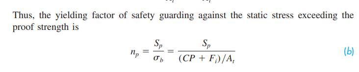

The yield factor of safety is given by
As can be seen n_o reduced with increasing P.
So you need to know your P and design bolt such that n_o is never less than 1.
So there is no alternative for a proper design.
By the way if your load is variable or alternating you need to consider fatigue criteria instead of yield criteria.
