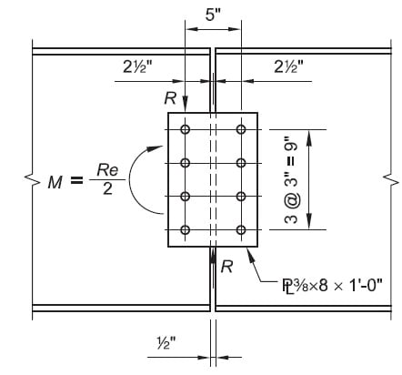

I am involved in a discussion regarding the behavior of a Bolted Web Splice Joint and looking for some clarity to understand the true behavior of the connection.
In an existing bridge(several simple spans), one of supports appears to have been constructed incorrectly (shifted by 3ft, whereas all other spans are of the same length). So a Bolted Web Splice Joint is observed in the beams of this span (span1).
Splice detail:
As seen above, there is discontinuity at the top & bottom flanges and the concrete deck above is also discontinuous at this location (expansion joint in deck directly above this splice). Hence it is my understanding that this connection is primarily a shear connection would resist shear and the resultant moment caused by eccentricity of the shear load.
i.e. The span 1 is equivalent of a hung span and the splice connection was never intended to take moment, i.e. the beams were not continuous.
The argument I have received from a colleague is that due to the size of the connection, the rotation of the beams is restricted and hence the behavior will be more like a "partial" moment connection with the system behaving like a 2span continuous beam and the web-splice plate carrying/transferring the bending moment at this location.
I do not agree and feel that flange-splice plates are required to transfer the moment at this connection and a web-splice plate only is not adequate. So I would model the two spans with a "hinge" at the splice location.
Bending moments are primarily transferred through flange splice plates and moment transfer through web portion is not significant. See sketch below:

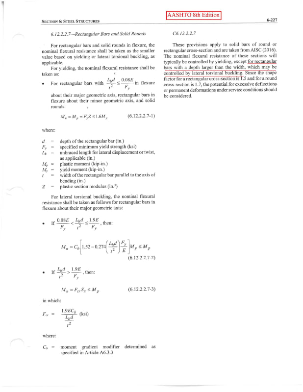

However the AISC equation reference I mentioned above which is also referred in AASHTO LRFD 6.12.2.2.7-1 uses Z without indicating any such criteria (Edit: realized that these refer to a general rectangular plate so not specifically at a bolted connection,
Which edition if the AASHTO spec are you using? In the 9th edition, that equation is for "Rectangular Bars and Solid Rounds", so it's not even applicable to plates, even ones without holes. The only other part of Article 6 that I could find that references the plastic section modulus is in 6.12.2.2.2, which deals specifically with steel box-shaped sections, such a box or tub girders.

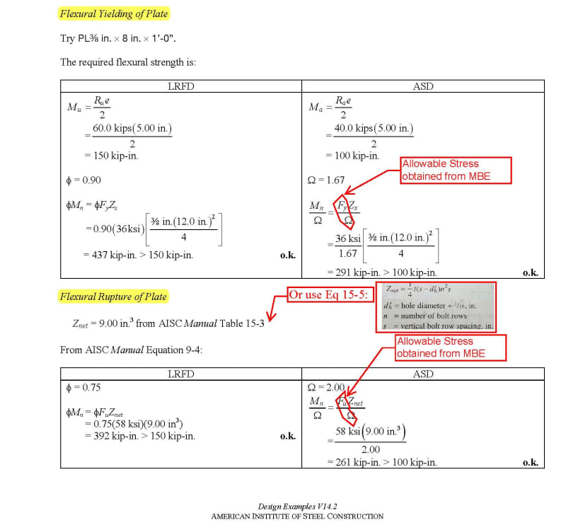

Checking the flexural capacity using the Elastic Section Modulus, S, tells you when the edge of the plate begins to yield. Checking the flexural capacity using the Plastic Section Modulus, Z, tells you when the entire depth of the plate has yielded.
AISC allows you to use to use Fy*Z instead of Fy*S for the flexural capacity since that is the point where additional load no longer results in any additional resistance (even though for moments beyond Fy*S the amount of resistance to rotation begins to be less than what is predicted by using EI).
When a moment is applied to the splice plate, the edges of the plate at the bolts will begin to yield first since Snet is reduced there. Then, since you already checked that Fy*S is less than Fu*Znet, the plate will then begin to yield at the region that has not been reduced by bolt holes. This is the point where a plastic hinge will start to form (meaning that the flexural rigidity is now less than EI). Now what you haven't confirmed yet is if a full plastic hinge can form (meaning that EI is 0). For this to be possible, Fy*Z must be less than Fu*Znet, otherwise the plate will rupture at the bolt holes before the full plastic hinge forms. This ends up just being a check that Z/Znet < Fu/Fy.

@BridgeSmith: Can you direct me to the AASHTO section which would be applicable in this case for the web plate? For the rectangular bars section AISC and AASHTO have the same equation using Z.
I don't think there is one. The closest analogous provisions would be for checking the flange splice plates, where the tension on the splice plate is limited to force that yields the gross section or fractures the net section, whichever is less (with the proper resistance factors applied (from 6.5.4.2). To relate that to the web splice, you'd calculate the moment capacity of the gross section at first yield and the moment capacity at rupture (fracture) on the net section, take the smallest of the 2, and use that as the capacity in your rating calculations.

I am referring back to AASHTO LRFD Equation 6.12.2.2.7-1 for "Rectangular Bars and Solid Rounds" and trying to understand why this section is not applicable to the web splice plate.
Per my understanding, this section is still applicable for plates, except that for the web splice plate the section depth > width, hence LTB will govern compare to yielding as mentioned in the section commentary.
This appears to be similar to the AISC section F11 which I have referred in my earlier response.

Yes, you still need to check the LTB for the splice plate. Based on the dimensions provided in your original post, assuming Lb is 8", and grade 36 plate, I come up with a Lb*d/t2 ratio of ~ 992, which puts each plate firmly in the "LTB will control the nominal moment capacity" camp.
@winelandv: Thank you for the calculation. Yes, LTB controls. I was conservatively using Lb=7.06" (clear distance between bolt holes)
I don't see how a bolted web splice plate can fail in LTB. Straight flexural buckling, maybe, but not torsional buckling.
Anyway, Section 6.12.2.2.7 may be applicable for plates (IMHO, I don't think so, since width is greater than the flexural bending length), but the holes in it changes things considerably. The applicable provisions, if anything in AASHTO is applicable, would be the provisions for bolted connections, and plates with holes where the capacity is calculated.
The AASHTO provisions aside, theoretically, you could use Z in your capacity calculations, but you'd have to calculate Z at the critical section, which would be the net section passing through the bolt holes.
Btw, there's also the failure mode of block shear rupture (6.13.4) that should be considered.

@BridgeSmith:
For the worst case with plate thickness b=0.35", depth d=31"
Elastic section modulus (S=bd^2/6) = 56.0in3
Plastic section modulus (Z=bd^2/4)= 84.1in3
Net Plastic section modulus at bolt hole (Ref. AISC Eg 15-5 in snapshot below),Znet = 52.5in3
The allowable stresses for Inventory condition per Manual of bridge evaluation for 33ksi material:
[ul]
[li]For Flexural yielding =0.55Fy=18ksi[/li]
[/ul]
[ul]
[li]For Flexural rupture =0.5Fu=30ksi[/li]
[/ul]
So, the calculated flexural capacity:
[ul]
[li]For Flexural yielding @ Gross section using S =18ksi*56in3=1008k-in[/li]
[/ul]
[ul]
[li]For Flexural yielding @ Gross section using Z =18ksi*84.1in3=1513k-in[/li]
[/ul]
[ul]
[li]For Flexural rupture @ Net section using Znet =30ksi*52.5in3=1575k-in[/li]
[/ul]
MBE does not seem to provide a separate allowable stress associated with Plastic limit, but how is it different from the AISC example I have shared earlier (see snapshots below):
