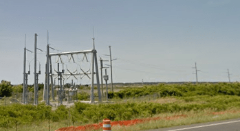

Couple years ago, while working on the new bridge, PCL cause a power outage for the entire Hatteras seashore because while setting a pile to the side for storage, cut thru the buried power cable. In the height of rental season.
Ocracoke Island is at the end of an 82 mile long feeder. When driving along the access road, ir feels like you are driving out into the Atlantic ocean.

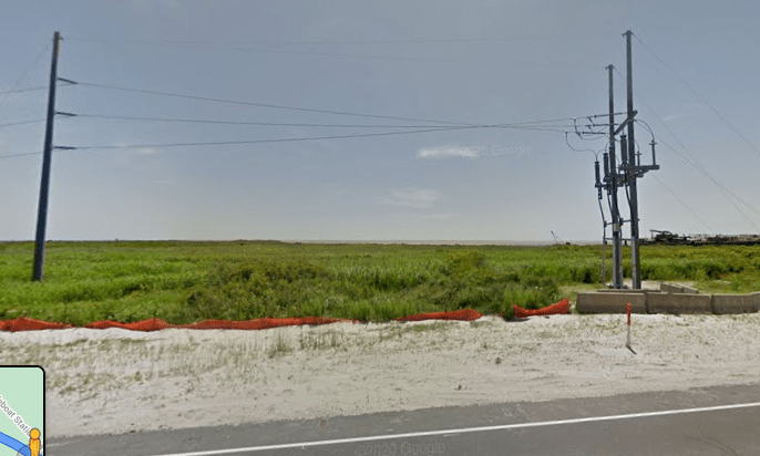

Here is a screenshot of the north termination of the cable that was cut in 2017, - now repaired.
This is the south termination post repair.

Ocracoke Island is one location where having a "microgrid" able to continue to carry part of the islands loads is almost a necessity. They still have a 3MW diesel alternate power plant.
