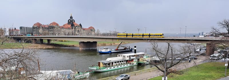

To me, and just based on the photos in that article, it looks like the tram/cycle/walking part of the bridge was at least partly hung off the side of the motorway bridge. Maybe an extension of the original bridge?
WOW. That doesn't look that old and Germany isn't exactly a nation known for engineering underperformance.

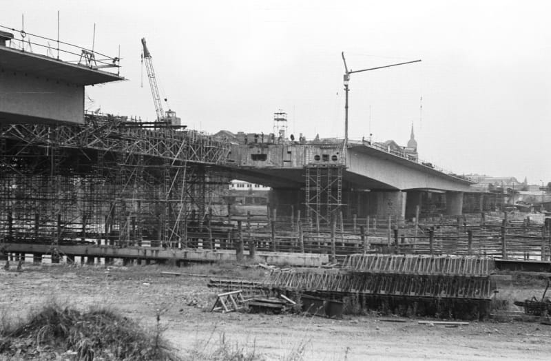

I'll throw my uninformed, speculative hat into the ring and disagee with hokie66. The bridge doesn't seem to be hung off the motorway bridge. I haven't dug up the time-line beyond being built in the late 60s, but the configuration would suggest that the tramline was built at the same time as the motorway.

This bridge was built during 1967 - 1971, so designed and constructed to whatever Soviet era standards were in effect then.

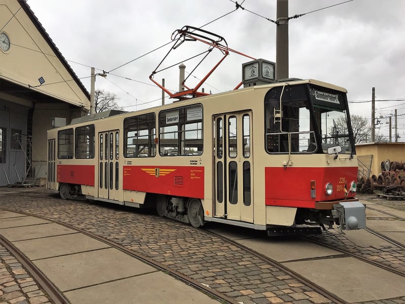

When it was designed, the trams in Dresden looked like this:
Now they look like this:

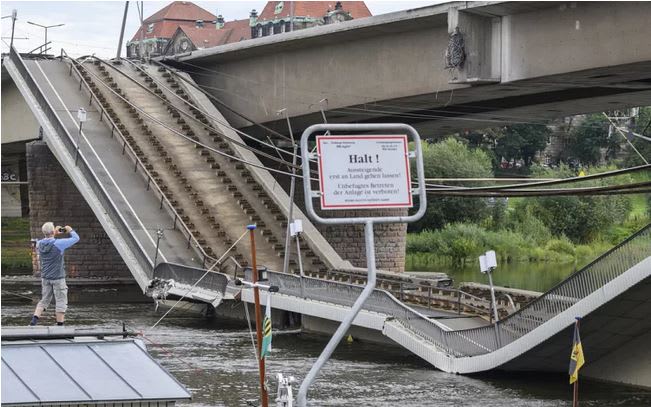

This photo suggests there was some connection between the tram bridge and the motorway bridge.

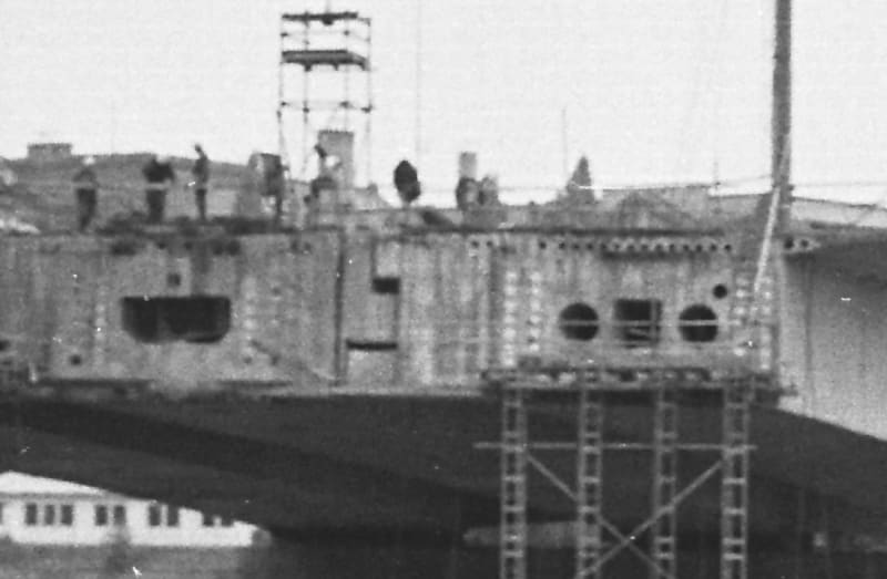

This is actually three bridges side by side, with some small connections between them.
It does appear to have been built in segments

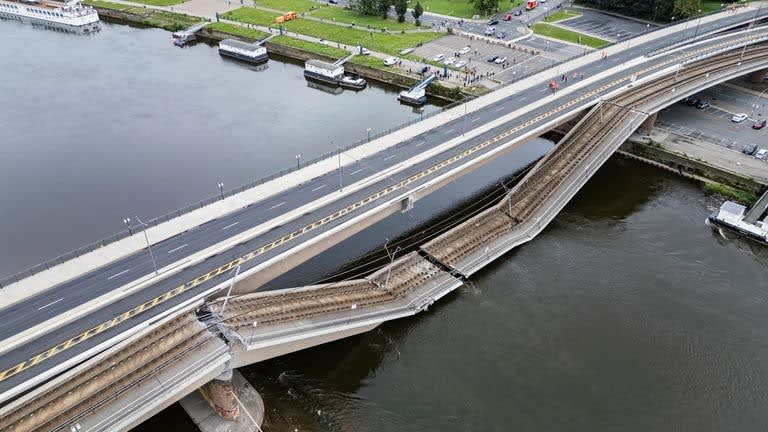

This is a better view.
Also the next section is now about to collapse by the look of it.
Looks like this is a prestressed concrete box girder with a very slendr arch.

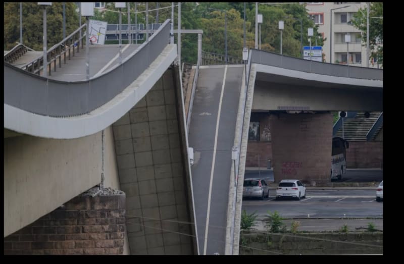

I know this is at a joint but there doesn't look to be a whole lot of rebar in there. They had refurbished bridges A & B and this was C, planned for the following year. Too late it seems.
Looks like they widened the bridge at some point for pedestrian and cycle lanes.
That looks like bridge A to be fair.

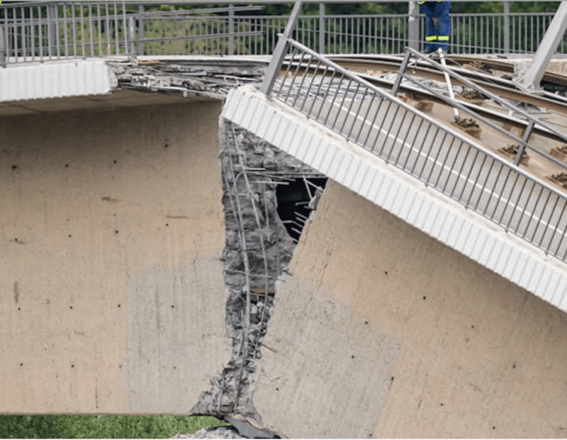

Gerber beams are non-redundant and a poor choice for bridge building. I wouldn't expect a lot of rebar in the so-called internal hinges which are designed for zero moment transfer by employing e.g., corbels or by terminating flexural reinforcement.
This part of the image looks odd. It looks like the part that fell would be applying tension to the part that broke, but it looks like concrete, with odd looking rebar.

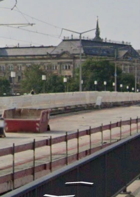

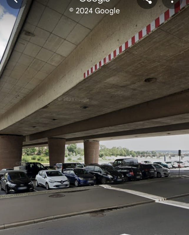

From the photo, the structure appears to sag at the connection to the left of the tram. This was likely a notable issue with a rollercoaster effect. I'm surprised it wasn't identified earlier. Beefing up the pier cap was a partial solution to a bigger problem.
From Google Maps, significant improvements were recently carried out on the center span.
I note that Mint's Wikipedia sourced image is dated March 2023. I don't see a corresponding dip on Street View which is dated "a year ago."
On Google Street View, there is a distinct dip in the pedestrian lamps. The lamp partially obscured by the tram power pole is definitely low. There is also a corresponding dip in the structure beneath the fencing near the right side of the image. These irregularities don't appear to be stitching artifacts from the panorama.

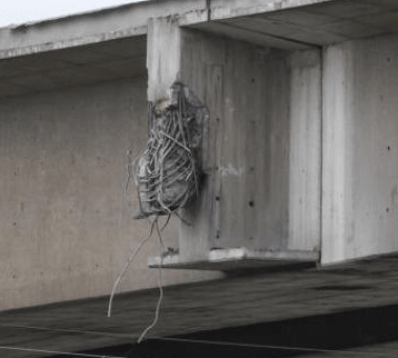

The key between the beams explains the strangely distorted rebar IRstuff (Aerospace) noted. To me it looks like the key was overloaded to the point where the concrete crumbled, leaving the distorted rebar behind.
Before
After
The key was not intended to hold the bridge up, it's likely good that it behaved like a fuse, or the load might have pulled the the center span down.
I doubt those are 'before' and 'after' shots of the same thing. But how this structure was supposed to work is all confusing to me.
The archive image is the A-B link whereas the damaged link is B-C. It looks like a different design but with the same purpose. Maybe a flexible link to accomodate varying deflections and vibrations between the independant spans.
