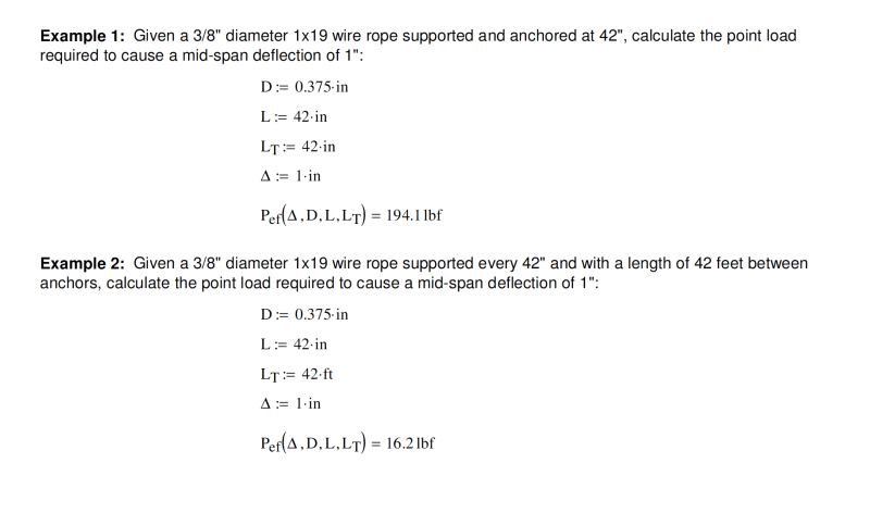

Honestly, I still do not see where they show the value for Lct
Is there an easy method to put a preload into the cable other than going from a snug (no/small) load using the extension calculated from using a turnbuckle adjustment.

This is what I was getting at with BridgeSmith. Big difference if the cable is 42" between anchors (Lct) versus 42 ft. using 42" balluster spacing.
Nobody was arguing that point (and it would be silly to do so, since it's an obvious conclusion), but again, the total length of the cable is one of the parameters in the calculations in the paper linked to by Deker. The examples you posted would seem to agree with the conclusions in the linked paper.

Agreed but their example and tables are unrealistic since no cable is likely to be anchored at 42" so if someone was to blindly use that info, it would be very unconservative.
