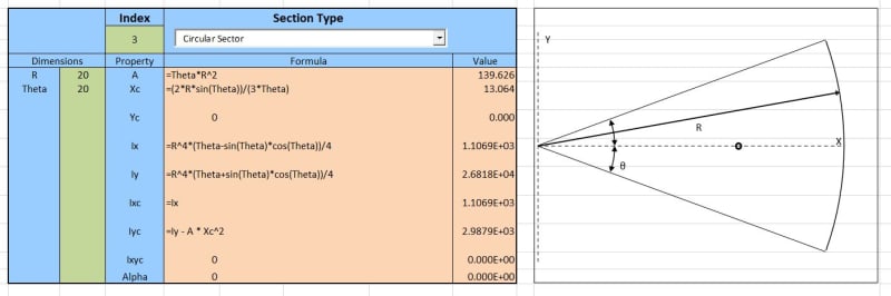

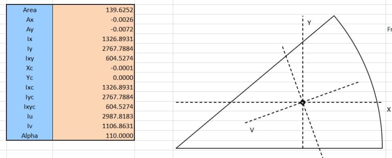

dik - with inch units and principal axis parallel to the X axis, and origin at the centre of the circle I get:
Rotating the axis by 20 degrees and moving the origin to the CoG I get:

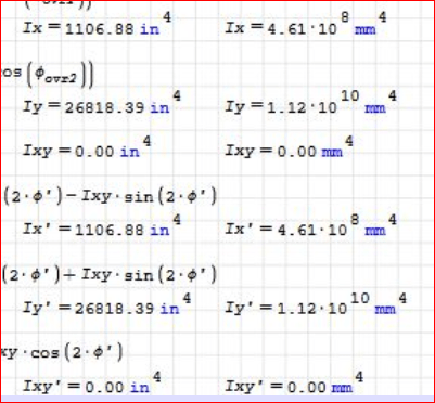

Note that your Iy seems to be with the Y axis through the circle centre, and your Iy' has the same value, but should be much smaller.
Your Ix' agrees with my Iv.
You have zero for Ixy' but it should be non-zero for non-principal axes.
Note that my second screenshot uses point coordinates with a large number of segments for the curve; hence the small non-zero values for the centroid and first moments of area.
Also I think we are over-complicating this. Why not find the section properties and section modulus values with the principal axes parallel to horizontal and vertical, then rotate the applied moments, rather than rotating the cross section?

So we agree that we don't need to rotate the section, but the Iy does need to be with the Y axis through the centroid (i.e. the IYc value in my first screenshot).

Iy/Ix = 24.3 seems wrong.
Ixy = 0 is okay when X axis is an axis of symmetry.
The primed values, Ix', Iy' and Ixy' can't be equal to the non-primed values, Ix, Iy and Ixy.

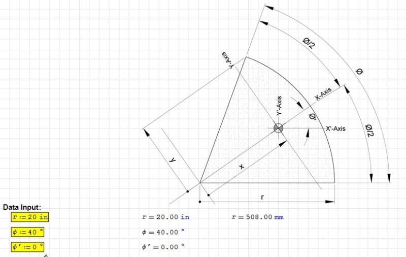

(ERROR: Iy HAS TO BE TRANSFORMED) They should be identical if the angle of rotation is 0 deg/rad. It was my only quick check... I didn't check the initial formulae.
(ERROR: Iy HAS TO BE TRANSFORMED) Not much to it... attached. If you're not running SMath... you should. Other than a couple of minor hiccups, it's a great free program and really useful.

With the origin at the centre of the circle and X axis passing through the centroid I agree with your Ix, Iy and Ixy values, and X axis centroidal distance, but:
Yc should be 0
For Theta' = 0 the Ix' and Ixy' are unchanged, but Iy' should be much smaller.
I get: Iy' = 2987.p in^4
Also the diagram is confusing, but I am assuming for Theta' = 0 the transformed axes should be parallel to the original axes.

With phi primed equal to zero, there is absolutely no change to the original x and y axis configuration so all aspects of Ix', Iy' and Ixy' should be identical to the Ix, Iy and Ixy values. That's correct... rotation if any would be about the centroid. The only thing I checked was that with the x value calculated... the y value is consistent.
But the prime coordinates have their origin at the centroid rather than the centre of the circle, so Iy' should be different even if the X axis is unchanged.
Doug Jenkins
Interactive Design Services
My error... I just realised the coordinates in the original drawing were at the centre of the circle... and not at the centroid. The Iy has to be corrected for the (area * x^2). Thanks, My apologies...

I accidentally transformed the coordinates from the centre of the circle segment to the centroid and should have modified Iy. Segment is symmetric about the x-axis so change in Iy is simply the original Iy less the (area times the x distance squared). Ix doesn't change. I've noted the error in the messages above. A log of changes to the program show up in the SMath program, but not in the *.pdf file.

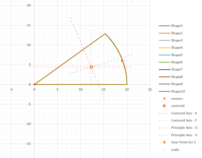

I get the same properties as IDS, for the 20" radius and 40 degree sweep. I also have the stress worked out with general bending formula or transformation of bending moment to the principal axis

At User Point
x 19 in Dist. To U 6.8421 in
y 6 in Dist. To V -0.8602 in
Sx 866.2574 in3 Su 436.6901 in3
Sy 411.6556 in3 Sv -1286.7314 in3
Elastic Stresses at user point from loads applied at shape centroid
P = 0.0000 kips 0.000 lbs positive = tension
Mx = 10.0000 ft-kips 120000.000 in-lbs positive creates Tension on top surface
My = 0.0000 ft-kips 0.000 in-lbs positive creates Tension on left surface
σ,axial = P/A = 0.0000 ksi 0.0000 psi
Mx:
y (in) dy = (y-cy) (in) σy =( (Mx Iyy - My Ixxyy) / ( Ixx Iyy - Ixxyy^2) ) * dy [ General Elastic Bending Stress Formula which captures non principle axis bending, if Ixxyy = 0 reduces to the common stress formula = Mx dy /Ixx ]
6.0000 1.5318 153.8349 psi
My:
x (in) dx = (x-cx) (in) σx =( (My Ixx - Mx Ixxyy) / ( Ixx Iyy - Ixxyy^2) ) * dx [ General Elastic Bending Stress Formula which captures non principle axis bending, if Ixxyy = 0 reduces to the common stress formula = My dx /Iyy ]
19.0000 6.7237 -147.4850 psi
σ,user point = 0.0063 ksi 6.3499 psi [From General Bending Stress Formulas using Geometric Bending]
σ,user point = 0.0063 ksi 6.3499 psi [From Transformation of Bending Moments to Principal Axis]
Principal Axis Moments
Mv = 9.397 ft-kips 112763.114 in-lbs σ,v = -87.6353 psi
Mu = 3.420 ft-kips 41042.417 in-lbs σ,u = 93.9852 psi
σ,bending = 6.3499 psi
