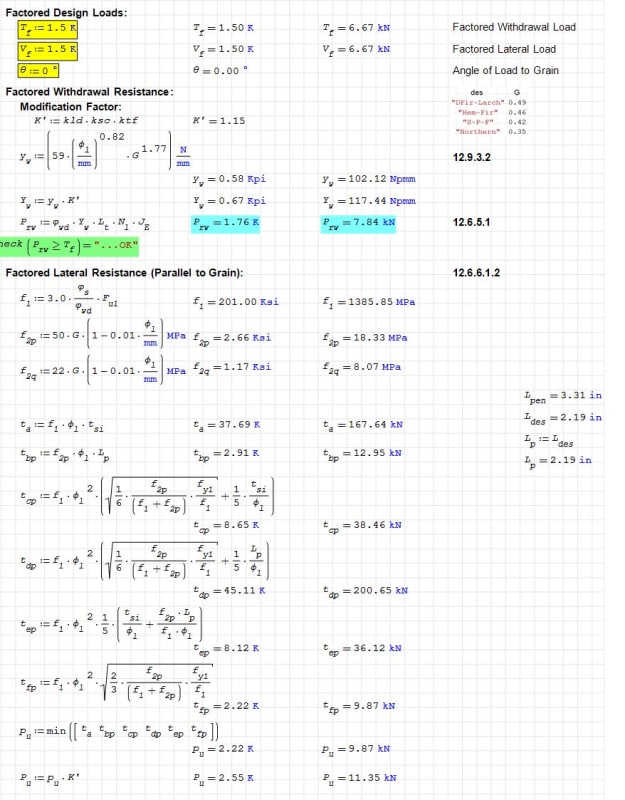

It's an excellent program... with a few little hiccups, but generally very good. I've written hundreds of programs using it... almost anything I have to design more than a couple of times, I'll do it up. Getting the hang of writing the formula is difficult to start with but after a while I can do formulae almost as fast as writing them. It keeps track of units, very well. I've attached a snapshot of my current program on lagscrews to show the complexity of the formulae. The text in blue are the units and the program takes care of them, too. Only downside to the program is that it was written by a Russian dude and that my have political fallout... I'm not concerned about such stuff. Larger programs can be written by cutting and pasting parts of other programs. Most of my programs are over 10 pages.

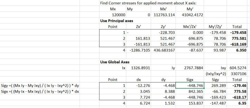

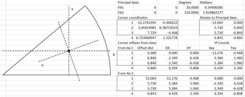

Here are my stress calculations. Using the same section as before, all in inch and lbf units:
First find the offsets from the points where stresses are required to the principal axes (points 1-3 are the corners, point 4 is the point used in Celt's calcs:
Then calculate stresses using the principal axes then the global XY axes:
So the results are consistent and also agrees with Celts results.
Having worked through the process I now think it is simplest to use the original axes with the full bending stress formulas:
Sigy =( (Mx Iy - My Ixy) / ( Ix Iy - Ixy^2) ) * dy
Sigx =( (My Ix - Mx Ixy) / ( Ix Iy - Ixy^2) ) * dx
The spreadsheet is attached below.
