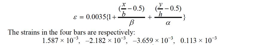

This is from "Reinforced concrete design to eurocodes" by prab bhat, page 371.
I have two things which I'm confused of.
1:
I'm bit confused of how did they assumed (chose) the alpha = 2 and beta = 1.5 for the first line? Why not something like alpha = 2.1 and beta = 1.4.
If they used random data (2 and 1.5) with even slight variations like alpha = 2.1 and beta = 1.4, then the axial force and moments would render a different result.
So what is the reason of that choice. It can't be random, or can it?
2:
Further, don't we need the My/b2h table as well to have a combined chart?
or this mx is used as a seperate chart and then for My, another chart is being used to design the other axis seperately?

These are randomly selected to start with ,but you should select different α and β to locate NA so to cover the total cross-section and draw the chart with reasonable accuracy.

The Fig. 9.22 Column design chart for axial force and biaxial bending is valid for My/b2h=2.0 only. Total biaxial bending graph is 3D like bulb.
The following excerpt from NARAYANAN , Design of RC Structures.
Notice that Case (a) , My =0 and Case (b) Mx= 0 , these are unique and uniaxial bending while Case (c) biaxial and there can be a lot of different cases.

Thank you for the response.
So, that means the method in the book cannot be used for real life design of columns. That method is not accurate?
Why can't we separately produce two charts for each axis than using a "bulb" like graph?
I mean, we already know how much maximum strain a specific steel bar goes through, and the contribution ratio for each axis (eg: -0.230, -0.315, for the bar 1) (the method in that book).
Then why can't we just use one of the contribution ratios (let's say we chose -0.230 for x axis), then calculate the new maximum strain for that specific bar for x axis, and produce a chart by considering it as a uni-axial column. And then do the same for other contribution ratio -0.315 and produce a chart with it. Then we will have two seperate charts for each axis, but fully compatible for bi-axial design of column. Is that incorrect or unsafe method for real life situations?

The method ( The column capacity for biaxial moments ,the three-dimensional interaction failure surface ),AFAIK the method used at design softwares .( I know e.g . SAP 2000 uses Biaxial Interaction Surfaces ) still the most precise method.
But for manual calculation,
- Follow EC-2 Bresler's formula or ,
- BS method , equivalent moment in one of the axes if applicable.
