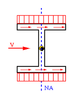

The only reference I can give you is the steel design manual. You'll see that it's provisions mostly use the full area as the plastic shear area. It always surprised me that was the case for the flanges of wide flanges in weak axis shear but whatever.
The 2/3 business comes from treating plate elements elastically rather than plastically. So that parabolic stress distribution rather than a uniform one.
@Kootk:
Thank you, this make sense to me, and I will regurgitate for my own understanding
If stress distribution is considered elastic then then it would look like this (and the area under the curve would be represented by 2/3 BxH):
If stress distribution is considered plastic then it would look like this:

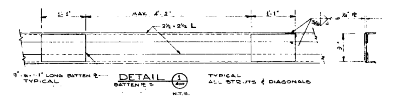

On another note, this is another built-up shape (angles and batten plates creating a C-shape) in the structure I am analyzing (old structure from the 1960s), I think using the elastic shear stress distribution would be more applicable for this shape.
You're most welcome. Regurgitation approved.
With regard to the battened members, how you treat it for shear is going to be a function of the degree of composite behavior that you plan to avail yourself of. If the two members will be expected to behave compositely then the shear response of that composite member is likely to be dominated by the vierendeel truss aspect of that behavior and not the shear deformation of the angle legs.
