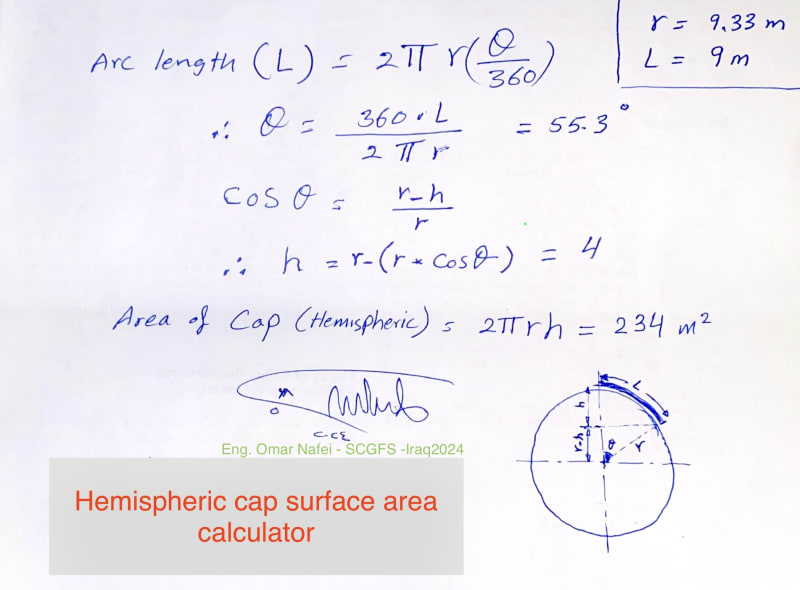

Hemispheric cap surface area calculation
INSP79
Nov 2, 2016
17
Calculation depending on arc length & radius
QED

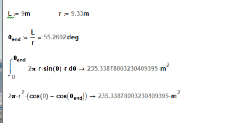

I was wondering where the integration step in the OP image went to.
Surface area of sphere portion = 2πrh is a well known equation. It works for ANY portion of height h on a sphere, not just starting at the top. Of course that's also the surface area of the enclosing cylinder of radius r, which is how it's easy to remember this formula.
So , what is the thread ? Review of the calculation or prove the spherical cap area Quod Erat Demonstrandum ? If so yes.. good job.

Surface area of a sphere = 4 pi r^2, so surface area of a hemisphere (AKA half of a sphere) = 2 pi r^2. Why make it complicated?
