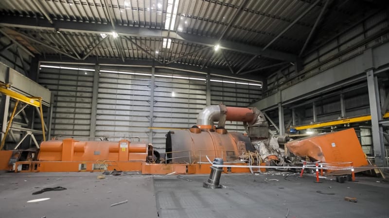

This is a screen clipping from the below video, bottom right is the HP IP turbine then in the centre is the LP and then on the left is the generator.
Turbine hall was evacuted before the incident, by reports due to the "turbine not sounding right" and "overheating" according to un-sourced claims in the AFR.com artlice below
That shaft and coupling broke and were tossed out into the concrete sinking a foot into it. Seems more like maybe it went radically out of balance causing the shaft to fail.

A radically out of balance condition could include loss of baldes. The HP turbine location looks a bit battered.
There are some bright spots in the roof that are not light fixtures, possibly holes resulting from flying parts.
TBF that looks like a concrete cover over some sort of void, but a big bang for sure.

the damage to HP/Ip seems concealed by the extremely damaged lagging.
I can't tell if the piece of the coupling embeded in concrete is A or B (between IP and LP or LP and generator)

Not a concrete floor but a steel grid mesh floor, not enough spalling for concrete floor, during overhauls they cover with ply wood. Highly energetic failure for sure though, LP and generator didn't suffer like the IP HP side.
I bet the person who ordered everyone out of the turbine hall is glad they made that decision. Usually work this incidents it's questioning why people weren't evacuated.
Given that the generators casing is largely intact that would seem to rule out hydrogen explosion? If it was an issue with hydrogen leaking into the LP turbine through severe vibration it would detonate the LP turbine.
300kg debris craned from the turbine hall roof. Wonder how far debris spread. There are a few new sky lights.
