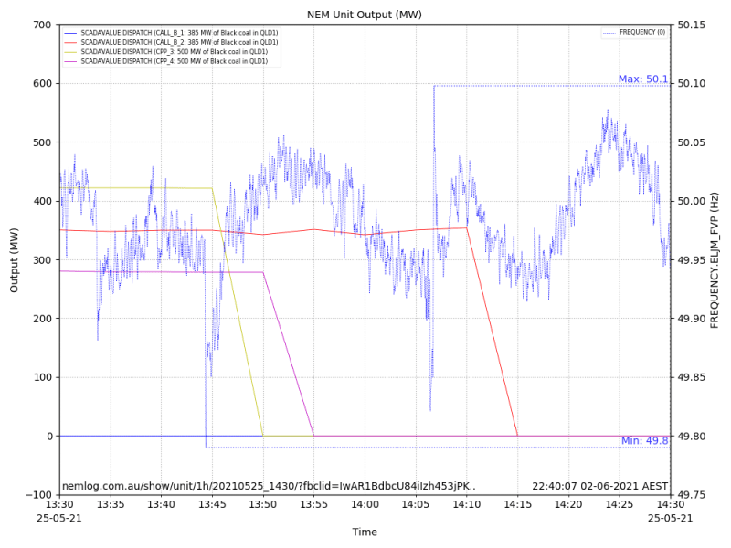

I haven't been able to sort through NEMlog, BUT found this in another forum post

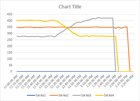

If I read it correct, it appears unit C3 dropped load prior to C4 (might be plotting squew due to sampling rate)
the C4 reduction (and c3 increase) had only occurred an hour or so prior Looks like B was able to ride excursion for a few minuts
I think you are right about the sampling rate squewing the plot, although it would still be interesting to see why Unit C3 still tripped first even if only fractions of a second(but due to polling rate of data it's logged as 5 minutes earlier).
Either fire fighting/electrical safety would have been the reason for B2 to trip. If GCB remained stuck closed after the turbine disintergrated then fire fighting would have been hammpered due to safety. Yard breakers may have been the only way to safely de-energize everything?
Actually judging by the frequency plot it appears that C3 did trip off before 13:45 sending the frequency through the floor (as lossing 400MW would do). C4 didn't have a much effect on the frequency after droppping out. Still 4 to 5 minutes between C3 tripping and C4 ceasing to exist.

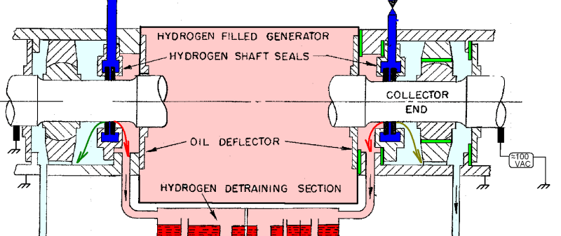

explosion of H2 in a running generator are rare. Unless the operators let the purity go to hell. A funny noise could have been a loose bar or shorted turn that eventaily cause a ground fault. then the generator "braking" far exceeded its load and rung the coupling off
maybe posible that the generator shaft seals were blowing by, bearing cavity filled with H2/air mixture, then a spark from the grounding bush/braid strap. wipeing the adjacent bears, locking up the inboard gen bearing

13:34 Unit 4 stops generating power while remianing connected to the power system(first big drop in frequency on the above graph)Generator starts drawing approx 50MW and 300MVAr.
13:40 CS energy report turbine hall fire.
13:44 C3 Trips (second big frequency dip).
14:06 Calvale Yard breakers are triggered. Dropping B2 of the grid triggering the cascade of other units, Total generation capacity lost 3045MW( I don't think all units counted here were at capacity so this is total potential capacity)

would it be that the generator had a bar to ground failure, thus sucking in the 50MWs. the "explosion" in the generator was initated by the BIG arcing and then release of H2 (by blowing out the seal casings, leaving end shields intack) then the blast of H2/air.
I didn't notice the seperation of the turbine from generator (by sheared coupling) in the sequence. maybe for that "motoring" period it was just current to ground (with generator field LOCKED)
thinking about it in this context, I can see that the design of the H2 seal oil casings could be a "relief" blowout, thus endshields and casing not being damaged

Looking at the generator wrapper, I am assuming that Toshiba might have the GE type dual ring design with once through treated seal oil
