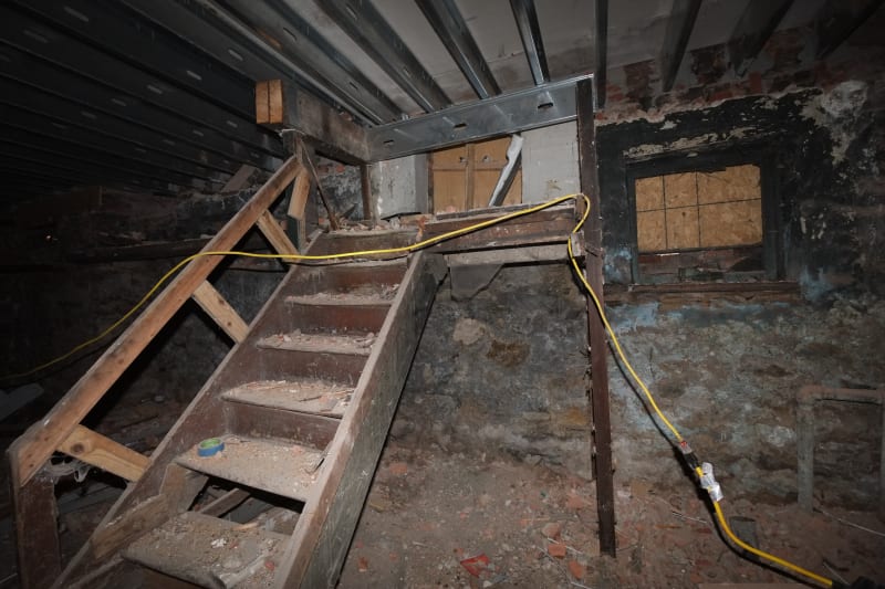

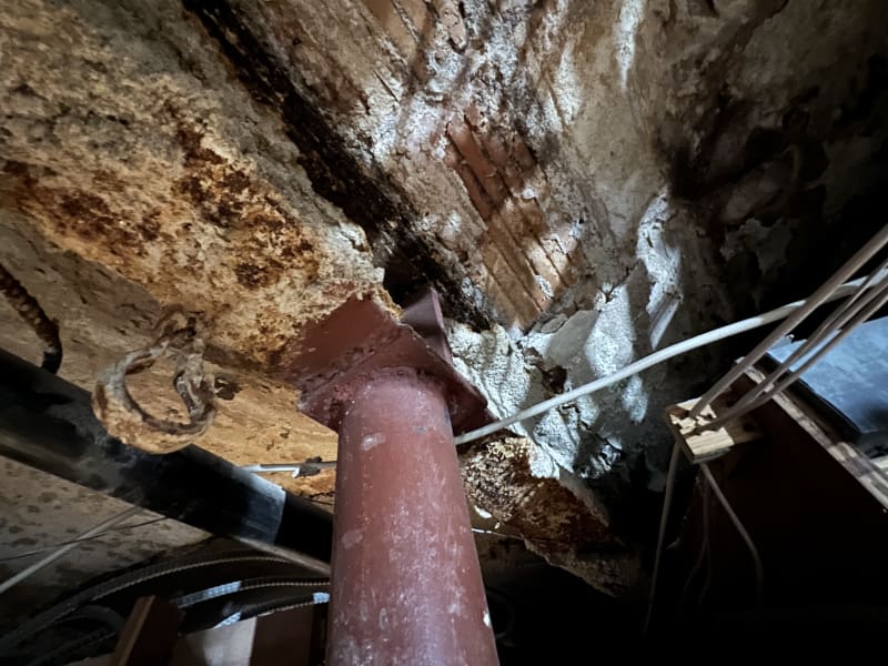

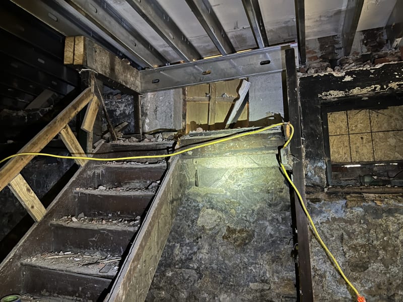

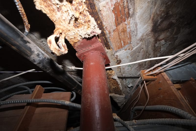

I did a direct comparison between iPhone and a real camera with flash (Fuji X-E1 camera + Godox TT350F flash) at similar angles. Conclusion: Neither one takes discernably better photos than another at my skill level, but the camera was more convenient to handle. I'm sure both can be improved with some practice and techniques.
iPhone + flashlight
Real camera + flash
iPhone
Real camera + flash
Some thoughts:
-Flash flattens cracks that are straight on, which is not good for structural inspection. Will use bounce flash next time, though exposing it is trickier.
-The photo of the column with the real camera is much clearer than the iPhone when I zoom in. Without zooming, it's hard to tell the difference.
-When climbing ladders, it was annoying to have the camera in front of me almost hitting steps.
-When not climbing ladders, camera was more convenient because it freed my hands for note taking (I use a neck strap). Probably will swing it to the back next time.
-iPhone kind of needs a flashlight in dark places, so both hands will be occupied. Otherwise, it goes to long exposure mode and the results are blurry/grainy.
-I was worried about the flash recharge, but it's not an issue at all. I fired off lots of shots in succession when panoramically photographing an area. Manufacturer lists it at 2-4 seconds, and it's more like 2 seconds.
