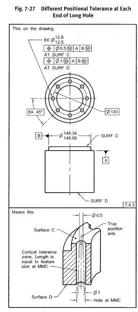

Tarator, Burunduk, Jacob, J-P,
If that's the case, then could you help me understand how the cylindrical tolerance zone concept goes together with what has been shown at both ends of the following feature:
pmarc,
That's a conical tolerance zone. Perhaps one can consider it a collection of infinite number of circular tolerance zones creating a cone. Just like a cylindrical tolerance zone can be thought of as an infinite number of circular tolerance zones forming a cylinder. The center point of the considered circular element can fall into any of those circular tolerance zones or in other words, it can fall anywhere in the tolerance zone cylinder as long as the position control doesn't intend to control the location of the toleranced circular element in the axial direction of the feature it is part of.
pmarc,
In your example, the position callouts are applied to a cylindrical feature of size.
In my example, it would be applied to a circular feature of size.

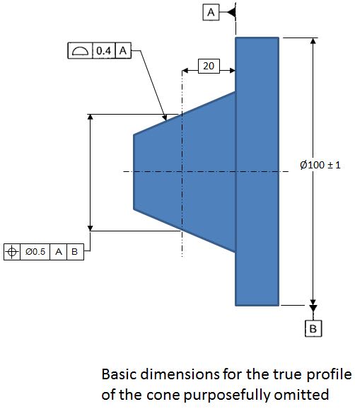

The conical tolerance zone example was not the best choice, so how about this? Why would the concept of the cylindrical tolerance zone by needed in this case?
pmarc,
In your last example, using a gage plane (20 BASIC from datum plane A) ensures that all actual measured points will be on that plane. And if that's the case, the tolerance zone is a circle.

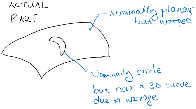

My original example was like this:
Tarator,
In your example, the first problem to solve would be how to find a center of the hole produced this way.
pmarc,
My thought process was to find a best-fit plane for all the measurement points of the actual "circle".
Then, you project all the points onto this plane. The UAME would be a circle (max inscribed circle) on the same plane.
The problem is that this best-fit plane and nominal plane, on which the nominal circle lies, will almost never coincide, which means the part will never be in spec.
