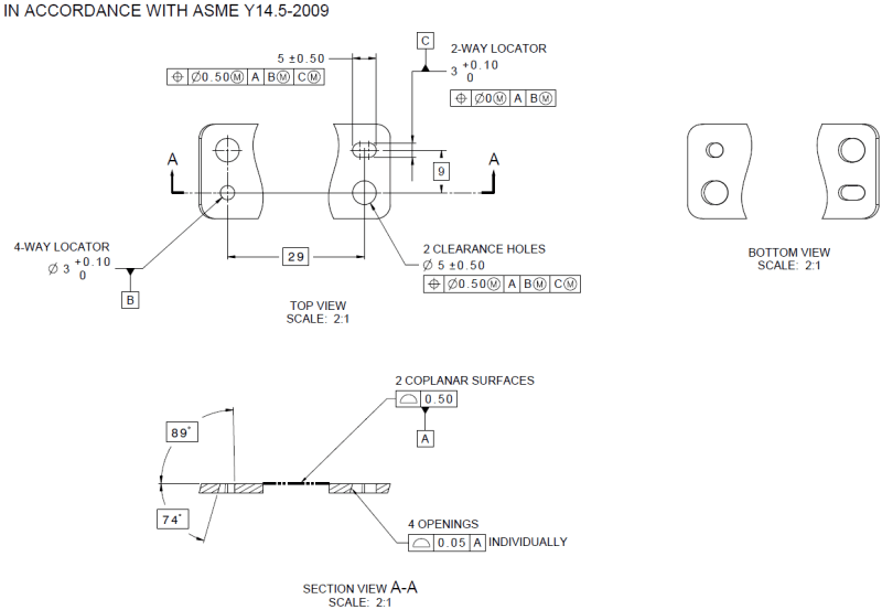

This was my original solution (see image below). All 4 openings are drafted between 1-16° gradually. 2 cylindrical locator pins and 2 screws go into those opening. I am not sure if the drawing represents my design intent. I would rather control them with size tolerance and position than a profile of surface because when you offset the surfaces, the openings won't be a circle anymore because of the variable draft angles. I hope this makes sense. I do have a 3D PDF but I am not sure how to attach it here.
Tarator,
According to the drawing you posted, I think I was correct that you want the size and position tolerances applied only on the intersection edges between the surfaces of the openings and a planar face (datum feature A).
The edges are nominally circular/slot-shaped at the intersection of the openings and datum feature A, aren't they? My interpretation for the reason you think that looking for best-fit planes and projection of points will be necessary is that as a result of the form error of datum feature A, the points on edges will not lie all on the same plane (you will not truly see them straight in section view A-A of a real part), is that interpretation correct or do you have something else in mind? Your description seems to be somewhat different and has to do with "offsetting the surfaces"(?) but I'm not sure I follow what specific issue you seem to detect here.
By the way regarding datum feature A - are these really two separate surfaces or is the gap in the middle created by a "broken view"? If these are separate surfaces it also looks like there are two separate parts.
I don't see how you can avoid using profile of a surface for a complete definition of the part geometry (even if position and size tolerances are utilized), the draft angles need to be controlled somehow. But if you keep profile of the surface in conjunction with direct size tolerances and position, some kind of solution has to be implemented to allow profile to control the form separately of size. There is the dynamic profile modifier in the 2018 version of the standard but since the drawing is per 2009 maybe a note is needed.

It is one part, but 2 separate tabs/flanges, hence 2 separate surfaces. I just cut the guts of the part out as it is irrelevant for the discussion.​
My intention was to use the Profile callout for the orientation (wrt datum A) and the form of those 4 openings. The size and location would be controlled by the size tolerance and the position callouts.

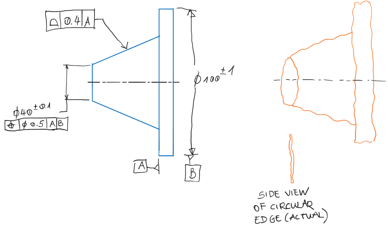

How about this version of your example? How would you interpret the tolerance zone? The actual element may look like a closed 3D curve. How do you find the center point? What is the shape of the UAME (circle, cylinder)? What is the shape of the tolerance zone of the position tolerance?

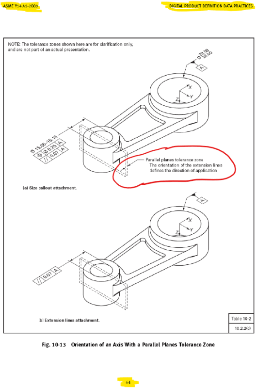

I think for any 2D feature (circle or 2 parallel lines) you need to introduce a supporting plane (gage plane, intersecting plane, etc.). For example, the length size of a slot? How can you find it without intersecting the two half-cylinders with a center plane? And wouldn't the tolerance zone of the position callout applied to it 2 parallel planes? See this image I found:

Tarator,
Your modification of my example is something I would not recommend to do in the first place. One of the reasons why would be exactly the picture in orange; if the as-produced edge is a complex 3D curve (which is quite likely to happen), how would its size requirement be even verifed?
In my example that problem does not exist because the measurement plane for the size and position requirements of the 2D feature is clearly defined.
