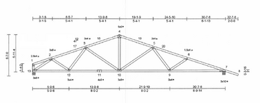

Can I please know the name of this software that designs trusses? 2

Thank you! I think this is a software that many designers use. A lot of designers and contractors have sent this type of calculations to me. Same kind of diagrams and the report format and everything. and it looks great too. Just wondering what the software name is
MiTek and Simpson Strong Tie are two that have the software. You need the correct license to produce those calc sheets.
I think most use Mitek software. It is unlikely that it is practical to own for anyone but a truss manufacturer.

Pretty sure that's a drawing from Mitek's software. They use the cumulative dimensions in addition to the panel dimensions.
I watched a webinar last week by a company called Paragon. They have truss software that’s aimed at general practice engineers; not just component manufacturers. It looks awesome.
