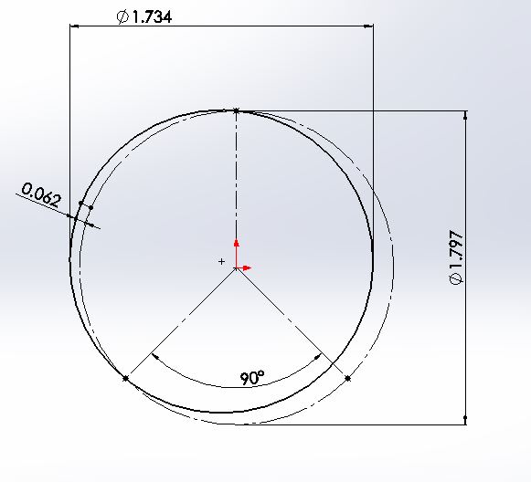

A simple question---Can we add MMC modifier on a datum feature established by datum target points? If yes, what is the VC size and how to build the gage? Please see the attached for details. Thanks

In the hypothetical case I presented where theres a third datum target opposing the two shown on the OP drawing, contact with all three would not be required the feature at LMC could slip between the pins specified at MMB - since the MMB for datum target points only consists of three points I don't think this violates an MMB based on datum targets. It might not be the job of the simulators to ensure conformance to size or geometric tolerances, but it is its job to reliably establish a DRF. In this case I would say its failing at that job - unless this behavior mimics the mating condition as the mating parts has an identical arrangement of three pins.

chez311, the behavior you described and illustrated doesn't fail the job of establishing a DRF. It allows datum shift, perhaps more of it than a "conventional" datum feature simulator would allow, but nevertheless, a datum axis is established, and for some cases, this allows sufficient control of the considered features controlled with reference to that DRF.

chez, thanks for the image. The problem is that were one to look at the virtual condition of that datum feature relative to the MMB datum targets, that virtual condition is larger than the calculated MMB, which is not the case of a conventional fully-enveloping fixture. Worse, there is no general method to determine the amount of excursion in as simple a manner as adding one diametral tolerance to another. In other words, the datum shift that is allowed is not easily predictable and the directions of the excursion depend on where the targets are.

A simple sketch like the one posted by chez311 can be used to assess the maximum amount of such datum shift. I haven't encountered a case that required such datum feature simulation for a simple cylindrical feature but others did. If this troubles you, you can ask the OP why it was decided to define the cylindrical FOS datum with datum target points in conjunction with MMB.

Mind that the ordinary case causes a simple part outline shift was well, generally equal to half the diameter; how long to analyze the result of the trefoil offset in that "simple sketch"? Not so simple.
