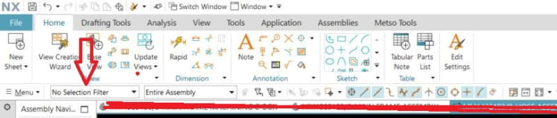

The first thing you need to do is check your filter settings.
Usually it's on the upper left side of your NX screen.

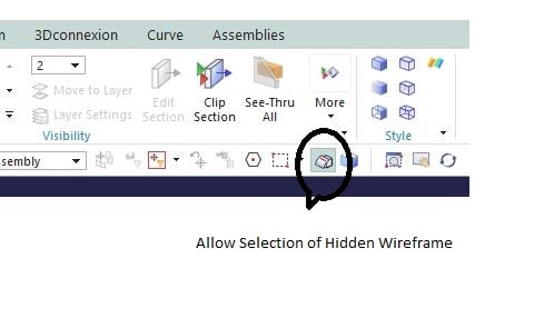

SUCCESS! Apparently I accidentally clicked on this button. I have never used that feature, on purpose anyway. I had a coworker open my file to test it and he had the same issue. However, his part worked fine. He finally found that setting.
Do you have the "allow selection of hidden wireframe" option turned on? In my install it is to the left of the snap point options; I think that is the default location, but I may have customized it.
Personally, I also like to turn on the "allow multi-select of hidden faces and bodies" and "highlight hidden edges" options (the 2 icons to the right of the highlighted one).
Edit: too late, looks like you found it already!
