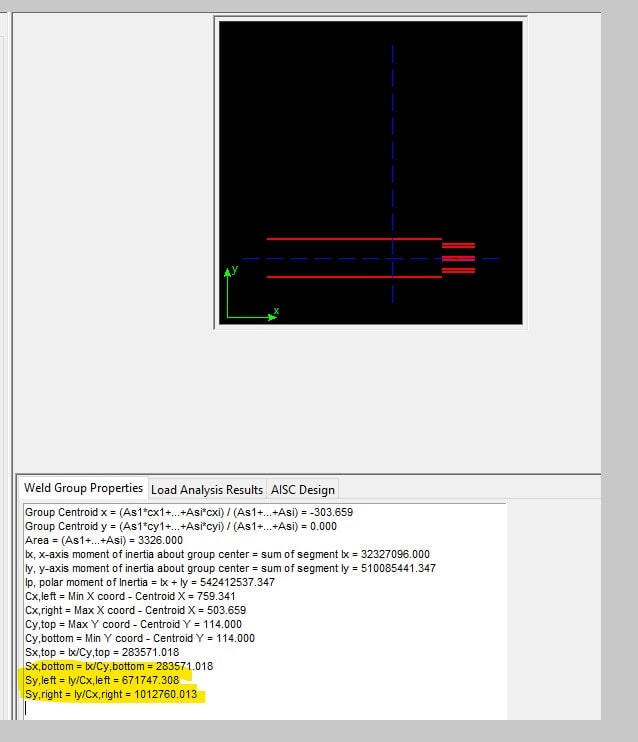

2. A reasonable way to evaluate the stresses in this weld? Currently evaluating as a line and have the below from my textbook in obtaining a "section modulus" for the weld (f=M/S_w [N/m]), but none are exact to how the load is in relation to the weld. Currently assuming #2 as it appears to be applying the bending along length of weld which is more similar than #3 which is about its leg (if that's right?).
(Based on the assumption above) I found a weld centroidal position and calculated the moment on the weld (as a line) from this point to where the load is applied. Sounds reasonable? Okey

The welds may be discontinuous but they are all on the same plane in that paper you provided which is what I really meant when I said continuous,there was mention of 3D weld properties but I didn’t see anything similar to what we are looking for and I even did a internet search.
But if you look at the welds the 200mm welds at the gusset connect to the top beam with welds at 90 degrees to the 1063mm welds we are interested in, the centroid of the gusset welds will lie in a different position to the (flange to flange) weld and depending on where the neutral axis sits in the vertical position of the gussets I would expect the stiffness and stresses to be different than those in the flange to flange connection. Well ignoring the gusset welds might well be very conservative or even unrealistic however to me it would be safe, also the calculations you did originally ignore the vertical gusset weld which connects the the top beam via a plate to the lower beam but I cannot see how a welds at 90 degrees to welds we are interested in can act as one. I will do aearch later to see what I can find. Another point is the flange to flange weld just stops at the end of the 1063mm dimension which might become a stress raiser.
Hi desertfox, thanks again for all your comments and working thru this with me, much appreciated!

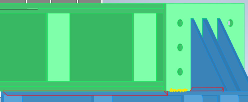

Okay I get what you mean by 3D, but the base of each weld lines on the same plane, that is the top flange of the lower beam. The welds all connect to the same object with their base on the same plane, their weld legs do go off in opposite directions.
Might just be me, but not seeing a clear reason why these two (red fillets below) welds don't compliment each other as described above.
When I look at the weld centroid as per below, and the screen shot above, it just looks right that the centroid is there, and that the beam will want to rotate about this axis (blue vertical line below).
The ends will likely be filled in with the yellow scribble above, though they probably wont connect to the red welds I have shown as I've heard that connecting 3 welds together from different angles is a no-no structurally (weld stress concentration).

The way I came to may conclusion was this, imagine the gussets are welded to the top flange of the lower beam as they are now, but were not welded to the vertical face at the end of the upper beam, now if this were the case the six 200mm long welds would not contribute anything to the welded upper and lower flange beams when the 350KN load is applied, now weld the gussets to the vertical plate of the upper beam and apply the 350KN load, the load path is transferred via the gussets to vertical end plate of the upper beam and and their welds but these welds are at 90 degrees to the original welds we were considering.
Is it possible that you could increase the lower beam in length on the underside of the upper beam to allow longer welds on the flange to flange connection? The over hang from left to right could remain the same as now and you would just extend the 1063mm overlap of the two beams in the right to left direction and thereby extend it sufficiently enough to allow the stress in the flange to flange connection to be below the allowable stress and then this problem goes away.
