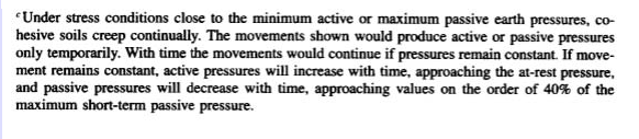

I normally design a retaining wall footing for a Sliding SF = 1.5. I use a friction factor for the dead loads and a passive pressure against the toe to reach the SF required. Any soil or dead load above the footing toe can be used as a surcharge to the passive pressure.
In the past, I have used the same passive pressure to add to the resisting moment. Also, I used the same passive pressure when calculating the soil bearing pressures.
For equilibrium, the sum of the horizontal forces has to be zero. So, the passive pressure may be zero or very low depending on how much frictional resistance is available. Passive pressure won't be present until the active pressure sliding force exceeds the frictional resistance.
This will change my bearing pressures in a more conservative direction. Am I thinking correctly?
