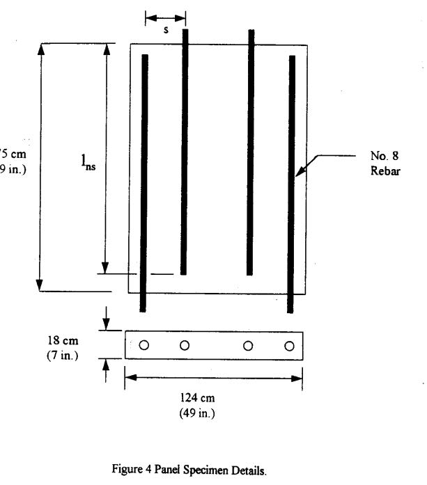

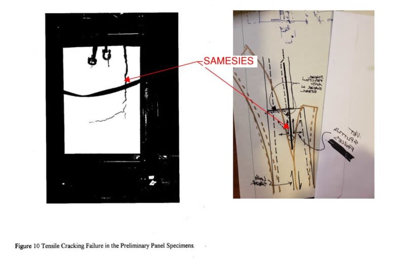

Somewhere on the continuum between "Hell no" and "Maybe kinda", again depending on who you ask. The details of this are spread out throughout this thread and it's not practical for me to regurgitate them all here. Maybe give it another scan and ask specific questions where you have them. The testing shown below is basically the situation that you've described. And you can see how well that worked out.
Interesting. Maybe because I the test was in an unreinforced thin panel?
Well yeah, that was the point. If the panel were transversely reinforced, they would have already applied the solution that the testing was meant to corroborate the need for to begin with.
Intuition is neat like that, huh. And yes, the corrugated grout tube in precast describes my example it perfectly. In fact, it gives us another example of development vs. anchorage. The corrugated tube almost certainly has some sort of supplementary reinf around it since, obviously, it is at a panel edge, correct? The mild bar will be developed into the grout. The grout, in turn, will develop 'against' the inside of the corrugated tube. The corrugated tube will then develop itself in the panel concrete through the exact same mechanism. Edge breakout is then restrained by supp. reinforcing. Any insight on the development of the corrugated tube? Sources/test/etc? I'm pretty sure you're following.

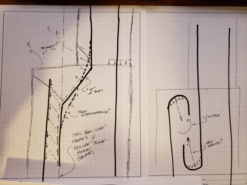

Aside from that, I'd like to discuss a solution for our wall problem here. See below for two questionable details. What is the behavior of such details. Surely someone has come up with a solution for this scenario? The left sketch adds some degree of resistance to the wall splitting in half as discussed. The right side is just me doodling. The splitting issue is not addressed by the right side i dont think.
Another
Strain in the ties as you have sketched in blue in your bluebeam sketch, Koot. You size this using shear friction type equations? Do those equations consider crack width/strain in the tie? I know ACI addresses this as it applies to cracked/uncracked in App. D land. Are there similar provisions for development? Forgive my laziness.

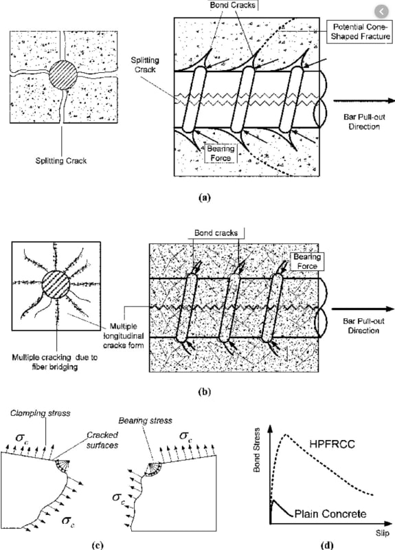

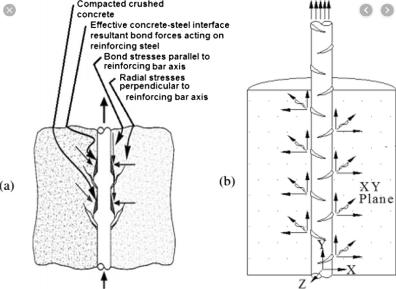

Here are some clips that help express my understanding of development of a bar. Also another questionable sketch:
