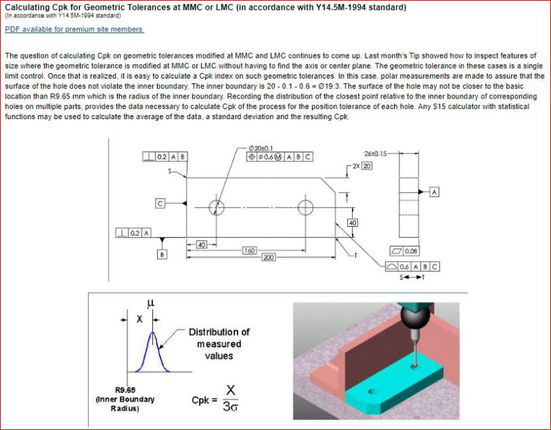

Does anyone know (or maybe has an article to post) on how to do a capability study on position tolerance at MMC callout using "Virtual Condition" boundary approach?
As far as I remember, and read, this method has been developed (and shown) by prof. Don Day few years ago.
Few questions came in my mind:
- is the capability study done on "the combo" size and position instead of position alone?
- in order to use known Cp, Cpk formulas, do size and position should be independent?
- is feature's size variation taken in consideration when "VC boundary" method used?
I found this online, but still not clear and not able to answer the questions above..
Will the calculation method be different if 2009 version is used?
I really appreciate if someone can provide detailed instructions on how to understand and apply in industry the concept below

While the size of the virtual condition for position tolerances at MMC (or LMC) is calculated by combining the size of the feature and its position tolerance, what really matters in the process capablity study for the the boundary method is the location of the actual surface of the feature relative to the virtual condition. Determination of the actual surface location is done without a need to separate feature size variation from its position variation.
For example, if we consider the drawing and the approach used in the tip, a workpiece with the actual hole produced at dia. 19.9 and perfectly located at its true position will give the measured value of R9.95 (19.9/2). The same measured value of R9.95 will be also obtained if another workpiece has the actual hole produced at dia. 20.0 with the actual position error of dia. 0.1 (0.05 off of the true position). This basically means that from the boundary method standpoint the two holes are equal - in both cases the smallest distance between the surface of the hole and the virtual condition boundary is 0.3 (R9.95 - R9.65), even though in both cases the holes have definitely different actual sizes and positions.

I don't think the calculation method for the boundary approach will be different if Y14.5-2009 is used.
One of the best explanations I've found for this is an SAE paper by a GD&T colleague, Dan Bauer. I don't think it's free, but it might be worth the purchase if you a really interested in the topic:
[URL unfurl="true"]https://www.sae.org/publications/technical-papers/content/2009-01-1546/[/url]

I would assume that most methods for directly calculating process capability for MMC position (that actually want to take advantage of the additional tolerance afforded by MMC as well as protect VC) would involve actual value for MMC or some variation thereof which combines size and position deviation. Ie: since for the surface interpretation an internal feature actual_value = size_MMC - size_RAME which can be compared to the tolerance value t_0 in the FCF, if you're actually interested in the radial distance (minimum distance/clearance) from the feature to virtual condition then your calculation would be radial_distance = (size_RAME - size_VC)/2 = (size_RAME - size_MMC - t_0)/2 . Of course a similar calculation could be made with coordinate/axis data* and the axis interpretation with the knowledge that the two calculations have the potential to deviate with increasing form/orientation error.
When it comes to actually monitoring the process and making adjustments to meet process capability requirements actual value and the related minimum distance from the feature surface to the virtual condition boundary alone don't tell you much about what knobs to turn. The attached article might be an interesting read. It focuses on two companies that disagreed over rejection rates because one was checking with attribute gauges (combines position/size and bonus tolerance into a pass/fail surface check) vs SPC (variable position/size data considered independently - essentially RFS without bonus) - the end of the article shows how the company was able to use the independent variable position and size data (without bonus tolerance) to shift the process to bring the process capability calculated with combined position/size data (including bonus tolerance) to the level required by their customer.
Admittedly I am not a statistics expert and the article definitely gets into the weeds a little, however even without the in-depth calculations there are some interesting conclusions.
Also the same author as the article (Paul Jackson) has quite a few forum posts on this topic, one of which he shares some of his spreadsheets for Ppk calculation based on measured position/size data.
*For the axis interpretation of an internal feature it would be radial_distance = (size_UAME - D - size_MMC - t_0)/2 where D is the amount of position deviation of the UAME axis.
