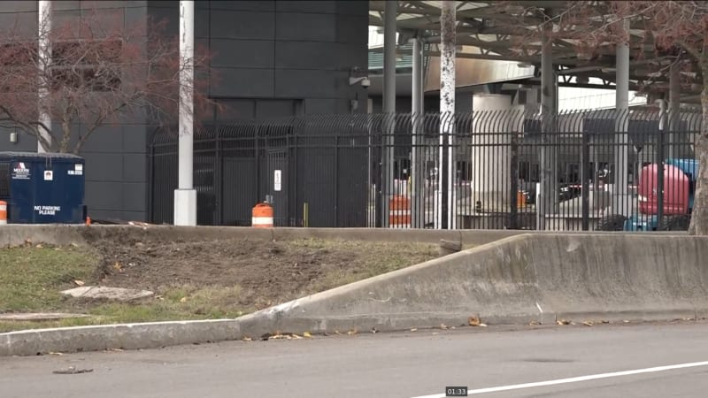

As suspected, the car launched off the grade differential, clipping the barrier on the passenger side.

I've been watching Steve Eimers, "The Guardrail Guy," who lost a daughter to impalement by a badly designed guardrail end that entered her car. He's made the point that roadside construction needs to consider what happens when it gets hit. I wonder what the design expectation was for that ramp or if it was just to blend between the curb and the wall.

Should we design every aspect of a road for a car that can potentially drive 150mph? Maybe it's more reasonable to design a road for the posted speed limit. I can't have sympathy for someone that chooses to drive a car that is unsafe on normal roads.
Imagine if we requires roads to be safe for motorcycles.
Tug, that detail would flip a car, potentially killing the occupants, at the expected speed, or deflect it to collide with another car.
In the UK in the air of motorways they have elevated platforms of the hard shoulder for police vehicles to park up and monitor the traffic.
They used to have ramps on both sides to drive in and off but now are reverse on drive off to avoid launching cars.
You need to think of the strangest things when it comes to cars and barriers.
