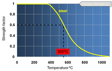

Regarding fire proofing of structural steel, I believe that it would be very rare to find any fireproofing of any "open-air" parking garages in the USA.!!! It is important to understand that the purpose of steel fireproofing is to buy time .... time for people to escape and time for the fire to become less intense.
As I recall, steel framed building failure under fire conditions is because of "loss of rigidity" (i.e. lower elastic modulus) as steel beams and columns heatup and are no longer aligned to their load path
Spray on fireproofing for masonry only structures makes no sense ... IMHO

Agreed. Some of the comments clearly are underestimating the danger that fire poses to structural steel. If you have a big fire that is not contained in a building with unprotected steel it is just a matter of time. And you don't have a whole lot of it either. This building seems to have behaved mostly as you would expect in the circumstance of an extreme fire event.
There is plenty of information out there. But most experienced structural engineers should have had sufficient exposure to know that steel doesn't like fire.

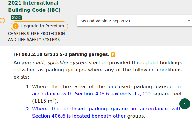

The ICC codes requirement for sprinklers applies only to enclosed parking areas meeting a minimum area requirement. Fireproofing is not a replacement for fire sprinklers.
3. Where the fire area exceeds 48000 sq ft (4460 sq m)
Line 3 was added with the 2023 code, appears to acknowledge that given a large enough area an unacceptable risk exists even when car parks are unenclosed.
The fire protection afforded by the precast concrete often used for freestanding parking garages is a side effect of the inherent nature of concrete. However heated long enough it will eventually fail.
I think given a similar situation to this one the end result under US codes would be similar.
