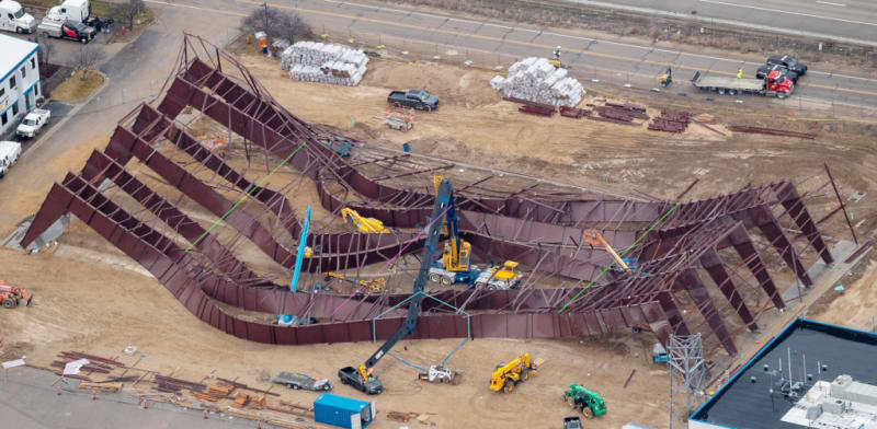

Once a structure of that mass deforms enough to snap the cross bracing, are they going to be able to pull it back into shape with a come along or would they need to utilize additional supports?
If the structure has just begun to buckle and some restraints are broken, but it hasn't yet yielded (i.e., it is still within its elastic limit), it can be resupported, likely using a crane, and then rebraced. However, if the structure has buckled past its elastic limit and the beams are permanently deformed out of plane, simply resupporting it will not restore the correct shape. This situation is fairly common with slender, long-span beams, which can be quite flexible in the out of plane direction before restraints and sheeting are installed. Presumably they were counting on straightening these ones up, before it all got away from them.
A reddit user suggested the collapse mechanism was 3rd order Euler buckling. I see it as 1st order between an east and west constraint. 3rd order is unlikely as it requires 9x the force while the structure has to successfully resist the first two orders. The buckling initiates in the top flange, which is under compression. The lower flange does not buckle as it is under tension and merely attempts to straight line. This results in the beams laying over in one direction on the centerline and then in the opposite direction as it ties into the constraints, a clever illusion of third order.
This may also reveal the cause of collapse being the absence of cross bracing where the cranes were located through the center half of the structure. This may be an unfortunate oversight given they had to remove the cranes before they could fall back and reinforce that portion of the structure.
Green lines represent east and west constraints of buckling, fuscia the centerline and cyan the remaining crane support.
Yes it looks like a first order buckle between the green line restraints, where the top flanges were under heavy compression. Presumably that instability led the way.
If so, that last beam led the way and pulled the whole mad thing over.
The pattern of torn column base plates shows the structure pulling to the south as it came down.

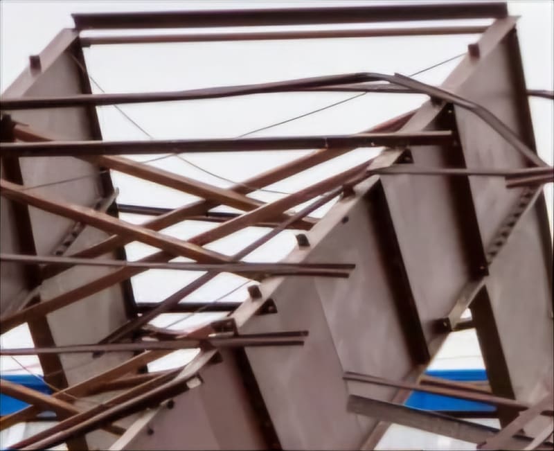

Reading the witness statements it sure seems like the main issue was a lack of temporary support, resulting in serious beam instability in the temporary condition. The drawings appear to show a lot more bracing and purlins than were actually in place at the time of the collapse. It sounds like it was buckling in various place. Those witness statements say they were trying to fix it with cranes, temporary straps, winches, and additional purlins, to straighten it all up, but that it got away from them.

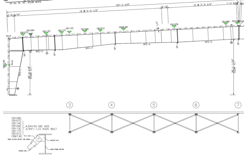

Some differences to start (please excuse my use of dwg. collages):
OEM calls for rigid x-bracing across four bays, concentrated more to the corner extremity than the center line.

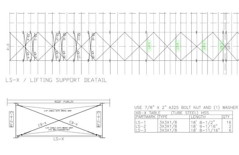

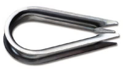

SBS utilizes rigid x-bracing for the corner extremity but then uses a cable tension system towards the center line. If this is at all functional, I see it as more trouble than it's worth. Furthermore, what is a cable brace grip? If there is no protection for the cable eye, that would lead to knife like cutting of the tensioned cable.
Also, the x-bracing isn't continuous across four bays, rather every other bay. As I mentioned earlier, these 300 foot beam assemblies in pairs are likely too slender to resist buckling and require the support of additional bays.

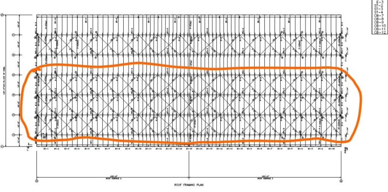

Yes the change from four bays to two bays within the depth of the webs wouldn't have helped. Presumably that's what they're referring to.
I was more looking at the in-plan bracing in the final configuration, which to me is where the primary lack of stability exists. In the final case you have a relatively wide bracing assembly, 3 bays wide, which would stop the whole thing falling over.

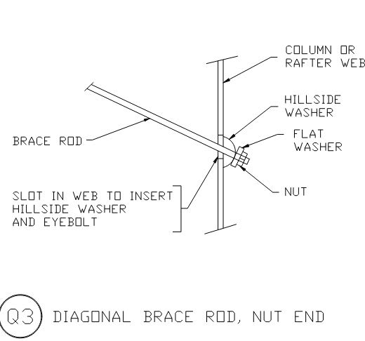

As for the cable grips, I presume they are referring to the hillside washer detail: (edit: It actually seems to refer to the LS cable bracing grips)
The cable grips are called for in the LS-X tension cable detail in the SBS collage I posted above. Depending on the specific item the designer refers to, it may not include the cable protection.
Did you find a connection detail for in-plan bracing?
Isn’t it the diagonal brace rod detail above?
Likely tabs under the flange. I'm wondering how they call the connection detail.
Edit: It is detail Q3 and a few of the hillside washers and nuts are visible beneath the top flange in the photo.
