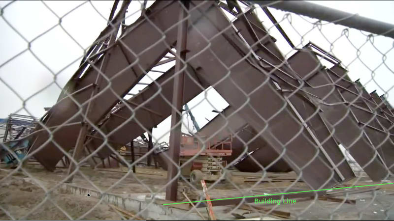

In the photo above with the green circle, it looks like there was horizontal x-bracing installed in the roof plane. Either cable or rod bracing.
It's possible the system pairs were not well connected to each other allowing the northwest beam pair to bow and initiate the collapse. As I pointed out earlier, the northwest bases have uniquely rotated and walked off the building line.

I think we will find that Human99 has nailed the cause of the collapse. My guess is that a lot of these erection companies simply get lucky on the majority of the jobs. Beams of this span and slenderness are an accident waiting to happen. Much like long-span wood trusses. The byproduct of having a structure that relies so heavily on it being completed to be "stable"

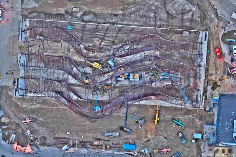

Significant updates last week as information is starting to become available and litigation efforts move ahead.
Beams were bowing and cross bracing cables snapped the day before.

Out of plane bending. Seems on the nose for a hangar.

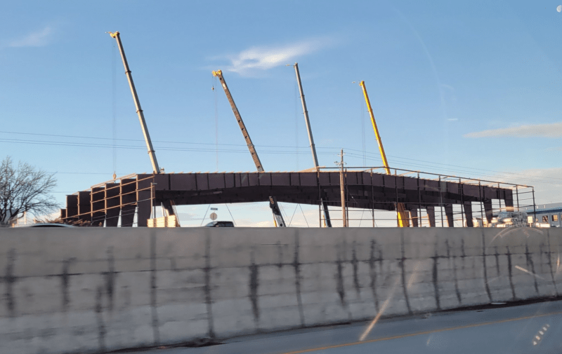

DMEPrecision's photo was taken the morning of the collapse. They were just starting to raise the final beam. If the structure was already bowed, it would have been awkward to brace the final beam to the others, at least if the bow was pushing through to or initiated in the south pair.

I had driven by this site hours before the collapse. As driving pass the site, and I noticed the lack of flagging on the top of the four cranes that were actively lifting the beams in place. I questioned the knowledge of the site contractor just on airport flagging of cranes, to my wife.
Still looking at the cranes being used to raise the steel, I noticed one of the cranes was smaller than the other three, maybe 2/3 the size smaller than the other three cranes. You can see the different crane booms in the picture. See the photograph on DirteJoe post above.

A shorter boom on a crane is not an indication of its capacity being exceeded. A crane with a longer boom can reach further away but at much a reduced capacity compared to lifts at close range.
