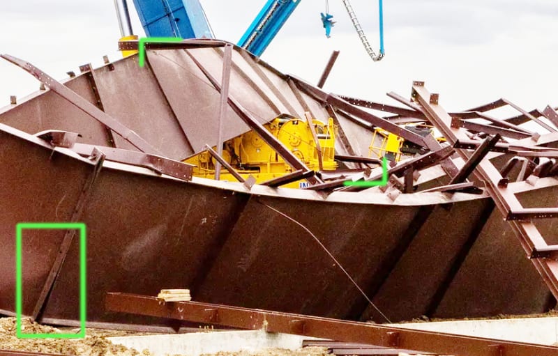

Edit: Uh oh, I spoke too soon. One cross brace LS-X tension cable (between green tabs) and missing bolts (though it may be likely they popped off from the collapse).
urnpublicidap.org2e29b1dbe4b529816517a565152ad336Boise_Building_Collapse_88983_m3wfes.jpg

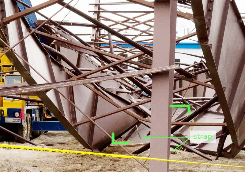

Another cross brace and a strap.

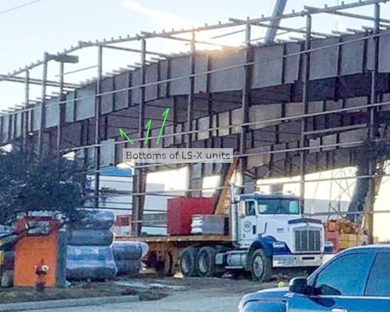

LS-X Brace is visible but the tension cables are not.
Sym said:
Edit: Uh oh, I spoke too soon. One cross brace and missing bolts (though it may be likely they popped off from the collapse).
Which cross brace and missing bolts? There's a few things in that photo.
The missing bolts are in the green box. The 300 foot beam is shipped in 10 pieces, 5 each side of center. I believe they were assembled into east and west halves before being raised and bolted at the center and to the top of the columns. The assemblies should be fully bolted and tightened prior to being raised. The connection plates in the photo appear to be separated, indicating missing bolts (at the bottom).
The green tabs indicate a length of brace rod (between) in the central area in question. I believe it would be part of the line 4 and 5 beam pair.
The second photo shows another length of brace rod, also part of the line 4 and 5 beam pair in the central area in question. I've tried to ignore the brace rods that are obviously closer to the corners.
Although the LS-X lower brace can be seen in the lower photo, I can't find the equivalent in any of the collapse photos, let alone the tension cables.
(I guess the green tabs look like arrows. That wasn't what I had in mind, they were just to frame the ends of the brace rod of interest)
Sym said:
The green tabs indicate a length of brace rod in the central area in question. I believe it would be part of the line 4 and 5 beam pair.
The one in the first photo looks like part of the LS cable bracing as opposed to diaphragm bracing.
But yes I can see the diaphragm bracing in the other photos. It would be interesting to know what the pop noises were. The LS bracing, the diaphragm bracing, or both.
