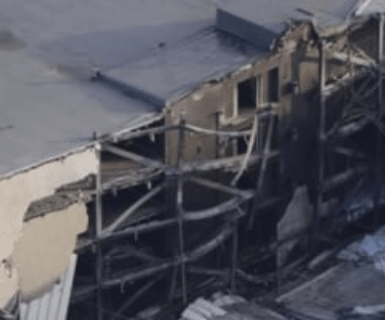

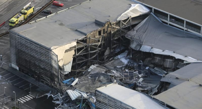

Another drone picture of the Luton Airport car park .... It seems that the fire was in the "newer" part of the garage
Several levels have collapsed on themselves.... In my opinion, this points to a systematic problem with the design

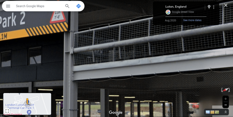

Zooming in on the google street view, exterior steel bolt heads are showing. This indicates that the steel was not covered with fire proofing.
(Enlarging the picture in MJCronin's post the interior steel most likely does not have fireproofing either.
Had fireproofing been applied, it would have slowed the structural steel temperature rise to the softening point, but might not have delayed the temperature rise long enough for the fire to burn itself out.
Lack of fireproofing on exposed structural steel is not necessary a design flaw, it depends on the building code specification.
The "code" apparently says 15 minutes fire resistance. Basically just enough time to allow people to escape.
If it's part of a building that would be different, but a free standing multi storey car park is 15 mins.
