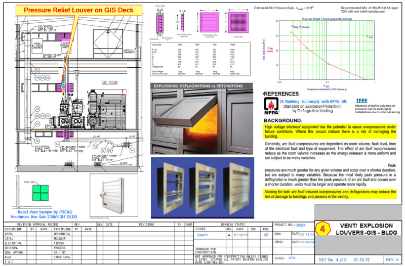

In the event of  internal flash-over occurred within a section of GIS the following potential issues should be considered:
. a)High frequency fast transient overvoltage could be caused unexpected failure on the insulation of other equipment connected to it and the grounding system.
. b) Gas overpressure can damage the vessel, rupture disk or other internal components of the GIS.
. c) If the GIS is installed indoor, there is a risk that the overpressure damage the building
Adding special pressure relieve louvers, could mitigate the potential damages to building and personnel For additional information in this matter, see the excerpt below from typical installation in 15 GIS substations for a client in the US.
Awesome! Can you increase the pic in size, its blurry on my end.
Thank you- again. :)
Can such a blast injure someone from over pressurization of the room? Even with vents?
Although the blast effect of sudden release overpressure has been some incident it is a rare event, however, there is potential for injury. Should be noted that there is no known injuries incident due to blast wave effect.
Injuries are a function of the levels of protection stand-off distance and predicting blast effects. Specific blast design concerns and mitigation options should be evaluated on a case by case basis for GIS project.
Will be prudent to take certain precautions and evaluate the probability of this type of fault and the consequences associated with this event.
