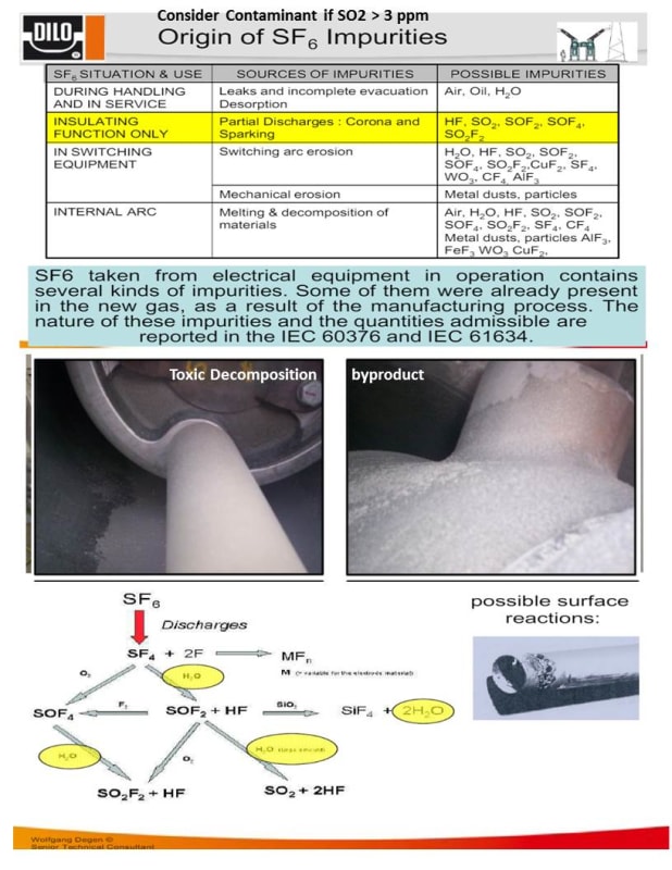

HUMAN EXPOSURE AND TOXICITY: SF6 is a simple asphyxiant. it is chemical inertness and it is very low accumulation potential support the low concern for the toxicity of this substance.][/i]
However, when electrical discharges occur within SF6-filled equipment, toxic byproducts can be produced that pose a threat to the health of workers who come into contact with them. (see below).
For indoor GIS, it is recommended to properly design the HVAC system to remove the concentration of SF6 close to the floor or the building basement. Below is an illustration of the effect of the toxicity of the SF6 courtesy of
Dilo.
The HF is one of the big problems, because the moisture to produce it is present in normal air: it forms one of the nastier acids. GIS facilities usually have showers provided to enable thorough rinsing after any accidental contamination.

I know SF6 is safe, but doesn't it produce toxic byproducts when subjected to arcing?
Yes, SF6 and other alternate gases as well produce toxic byproducts when subjected to arcing

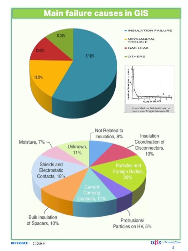

Are there any resources of published or documented GIS failures?
One good source is the CIGRE Report on the latest international survey on high voltage gas insulated substations (GIS) ser
vice experience. Below is a glance of the main failure causes in GIS collected from various publications.
