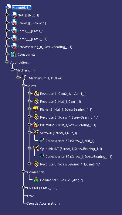

I saw a video in the youtube, link is here any one explain how this mechanism is simulated in CATIA V5 Kinematics. I created couple of revolute joints and a screw joint its not working. Any help is highly appreciated.
.The stp files can be downloaded from the below link
I removed the parts not present in the mechanism.
As a first step, I tried to constrain the assembly, observing the degrees of freedom... once I got the assembly to manipulate-with-respect-to-the-constraints the way I wanted, I proceeded with kinematics
planar; faces towards the shaft
prismatic; top faces & corresponding edges

Awesome, Thank you so much. Very much appreciate it.
Regards
Arun
