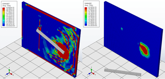

Read the Abaqus Theory Guide, in the official Abaqus Documentation, if you want to understand CDP. The constitutive equations can be manipulated however you need, but it's a bit hard to grasp if you haven't had coursework in elasticity and plasticity w/ continuum theory. The only "practical" advice I can give is that the damage propagation is mesh dependent and the model runs best if the reinforcement bars are modeled as line elements, using the embedded element constraints, not solid. That means your slab, beam, wall or whatever should not be meshed to be only 1 element thick.
I used to use this metal bar slamming into a reinforced concrete wall as a teaching example around 10 years ago. There are a lot of resources out there on CDP. It runs pretty slow compared to a lot of other constitutive models available.
