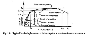

Trying to put everyone on the same page for what we are talking about with ductility... (apologies for any obvious explanations here)
Ductility as a material property is the ability to deform plastically prior to snapping e.g. pulling a piece of steel and watching it neck
The opposite of ductility is being brittle i.e. just snapping without prior warning e.g. jumping on a piece of timber and it goes boom
Ductility in the structural engineering sense is based on that principle and, in seismic deisgn, is used as a way of reducing earthquake design loads
Basically, we define an imaginary earthquake and say you can choose to resist this elastically (by strength alone) or with ductility (by allowing permanent damage to something sacrificial to dissipate the energy from the larger shaking)
In the context of a 'system' e.g. a portal frame or wall, obviously not everything goes ductile (permanently deforms) at the same time
So defining the yield point requires a push test and figuring out where there is a 'system' yield (i.e. you have developed a failure mechanism, not just when the first joit yields)
The ultimate point is normally where the strength drops to 80% of the peak
The ductility of the system is therefore ultimate displacement / yield displacement - this
I'm sure we've all seen variations of these diagrams - this is for a RC concrete frame
The implementation of this 'ductility' is very simple - code says the earthquake shaking is 0.90g (for typical buildings in my city)
By allowing 'nominal ductility' (ductility 1.25) this reduces to 0.71g, by allowing high ductility (say ductility 3.5) it drops to 0.26g
The USA R-value is basically the same thing I believe
Plasterboard can easily achieve ductility 10-13 by this definition - you'll struggle to get that out of many other systems
