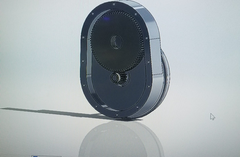

I have no industrial experience outside of my own garage. I consider myself humble about my current knowledge and am seeking advice on an idea I've had difficulty finding information about after extensive research.
What I'm exploring is the feasibility of a twin charged engine using a turbo feeding a clutched centrifugal supercharger that is oversized and designed for operational rpm before the turbo has "spun up." At this point the supercharger will disengage to prevent exceeding the max allowable impeller speed and a bypass around the supercharger will gradually open to remove the flow restriction. Pressure relief valves where necessary after closed throttle will be used. The thought process was to gain the benefits of a conventional twincharged (positive displacement) system with more flexibility in engine bay arrangement and the removal of any supercharger flow restriction during the turbocharger's maximum output.
As I said before I am a novice although I do have quite a bit of time under the hood and online for my short years on this planet. I'm looking for your guys' thoughts and predictions on this. There very well may be a major design flaw and I need help finding it or any advice for success. Thanks guys!
Just a little update on the project. I have begun construction on the supercharger using a Borg Warner S475 compressor cover and wheel with a custom gear housing and shafts. Bear in mind the compressor in the picture is not Borg Warner it is only for demonstration. The final design will have a Precision 6769 turbocharger feeding the centrifugal supercharger with a mechanical vacuum operated bypass valve similar to those used on factory sequential turbo setups like the V6 TDI biturbo motor. Of all the possible configurations this was chosen due to simplicity. An electronic valve may later be implemented for further improvement. The bypass will open when delta p for the supercharger becomes close to zero and attempt to hold the supercharger in zero duty while the turbo is at maximum boost. Theoretically this will reduce supercharger power consumption to only friction losses and the pressure drop in the housing due to viscous forces. I will update when the supercharger has been completed and passed testing phase. I will be running simulations of all transients with ANSYS CFX to determine optimal bypass operation and if a mechanical valve is capable of meeting such requirements. More to follow.

This sounds like a bad idea to me. Brian summed it up in post #6 - the centrifugal blower is not the ideal machine for low rpm grunt. BTW to make it do that, it needs to be UNDERSIZED for the engine to keep it out of the surge region under low-rpm/high-boost conditions. On changeover to the turbo you will need to uncouple the drive to the supercharger to keep it from over-speeding (with the drive ratio needed to produce significant low rpm boost). An air con clutch will probably do.
The bypass will open when delta p for the supercharger becomes close to zero and attempt to hold the supercharger in zero duty while the turbo is at maximum boost.The delta p will increase not reduce as you raise the inlet pressure. The PR of the centrifugal supercharger remains the same.
Use a positive displacement blower or staged turbochargers if you must twincharge.
Easiest route is not to twincharge at all - just use a positive displacement supercharger. If you must have the outright power of a turbo there are ways to fill in the bottom end - careful exhaust design with divided housing for blowdown, advance exhaust valve timing, larger exhaust valves, a shot of nitrous brings on boost nicely.

I guess I didn't clarify this will not be for low end grunt. Merely throttle response as the car will live in high rpm's on the track. If it was a street car you would be absolutely right about the positive displacement being better suited. The car will stay above 5000 rpm's on track with my gearing and rev limit. The purpose is to get instant throttle response out of the corner without antilag or nitrous. A pd blower will be more parasitic and difficult to fit in my engine bay.
Adding complexity to your system makes fast throttle response LESS likely, not more.
I either missed it, or that last post was the first time you mentioned the application for this design; i.e. this isn't a street car. As you move from a street driving profile toward a race car (i.e. much more time @ WOT, much higher mean RPM levels, etc) the advantages of a supercharger over a turbocharger fade rapidly.
This sounds like a heavier, more expensive, less reliable version of a well tuned turbocharged race engine.
If this engine really will spend all of its time in anger above 5000 RPM, and unless we're talking about a motorcycle or a very expensive/advanced car engine, you're trying to provide peak pressure and maximize throttle response over a range of maybe 4000 RPM.
With current variable vane turbo technology and even remotely competent tuning, achieving both of these goals simultaneously is not hard.
If this is for a trackday toy and your goal is just to have fun and do something crazy, by all means soldier on. If your goal is to build the fastest car possible for X amount of money- this is not it, pretty much regardless of what X is.
There are a lot of problems to solve which you've glazed over- namely what you're going to do with the high volume of high pressure air coming out of the supercharger discharge when you shut it off. Clutching the supercharger doesn't solve this problem, because the supercharger has a moment of inertia greater than zero; when you declutch, it will not stop, potentially for several seconds. Using giant gears to drive the compressor makes this problem worse, not better.
You also have to do all this in a way that doesn't cause the compressor to operate in a state across the surge line- unless you want to destroy a lot of compressor wheels and rebuild a lot of engines.
Once again, I implore study of the Kawasaki H2 and its mechanically-driven centrifugal supercharger, and the bypass valve that is built into the design to address the near-shut-throttle situation.
